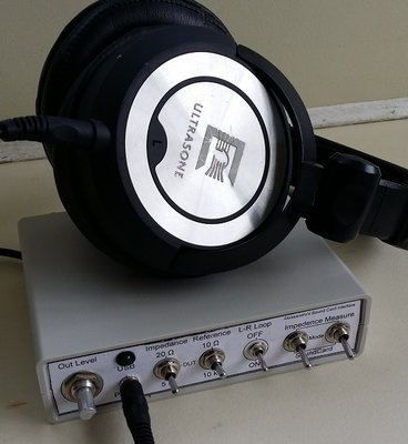

I decided to build a dedicated USB solution. I did more research and found the Behringer: U-CONTROL UCA202 a very decent and inexpensive ($30) USB sound interface. I preformed the mods listed here http://nwavguy.blogspot.com.au/2011/03/ ... endac.html to improve the low end response. This was probably the hardest part as it involved some SMD soldering. Then I added some switches and resistors to make calibration easier and put the whole thing in a box. I used some precision 0.1% resistors from vishay. Depending on components used the total cost could be below $50, not bad for a device that will take impedance plots, measure resistors, capacitors, inductors and estimate T/S parameters!

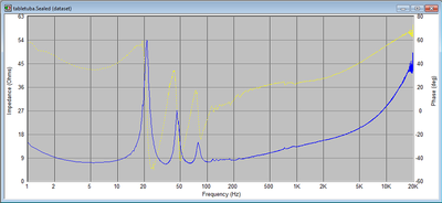

I've attached some pics and an impedance plot measurement of my table tuba. Can someone tell me if this is what the plot should look like?

Impedance Plot of Table Tuba

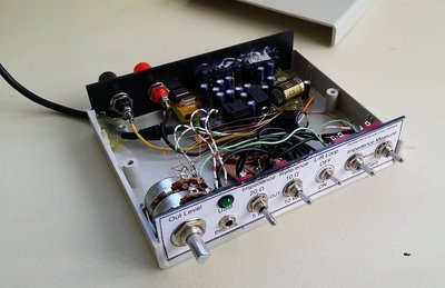

Yes its messy, but it works :)

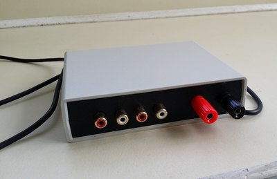

I've preserved all the inputs and outputs of the UCA202 so it can still be used normally.

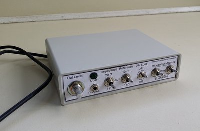

Front Panel
Front Panel
It also doubles as a headphone amplifier

Re: DIY USB impedance/capacitor/inductor measurement tool
#3 Post by LelandCrooks »
Looks about right. Nice.

#4 Post by Bill Fitzmaurice »
AlessandroAU wrote: I've attached some pics and an impedance plot measurement of my table tuba. Can someone tell me if this is what the plot should look like?
+1.
