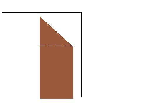

Do you mean something like this???:
(brown is sub, dotted line is end of normal sub (so triangley bit is the new part) and black is the walls).

Re: Another silly idea
#6 Post by jimbo7 »
Like this:

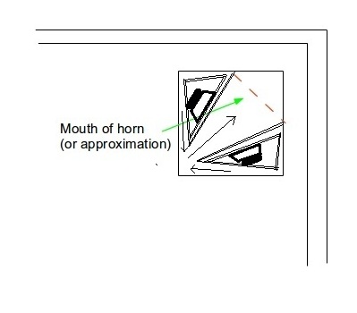

#10 Post by Ryan A »
sine143 wrote:the hardest part of horn design is actually folding it into a box ;p
your suggestion would make folding more difficult.
Here's what I would do *brainstorming*...two boxes in one.
In order to get a full 7-10 foot long horn the box would have to be around 36" X 36" though. It would probably use 8" drivers or 10" at the largest.
It goes without saying its a lot easier just to make due with the designs we have already. Its questionable how much of a difference it would really make too.

#11 Post by BrentEvans »
There's no way the horn path on that would be long enough.
If you really just want something that looks square, build two of whichever of Bill's designs fit, put a Vplate on top, and false sides around the front to square it up. It will work quite well and look nice too. Or, just square up a single cab to the walls... there won't be much difference at all.

BrentEvans wrote:There's no way the horn path on that would be long enough.
Umm, actually it would. If you really need THT extension it could be built larger.]
I personally wouldn't do it as it takes up too much floor space.
