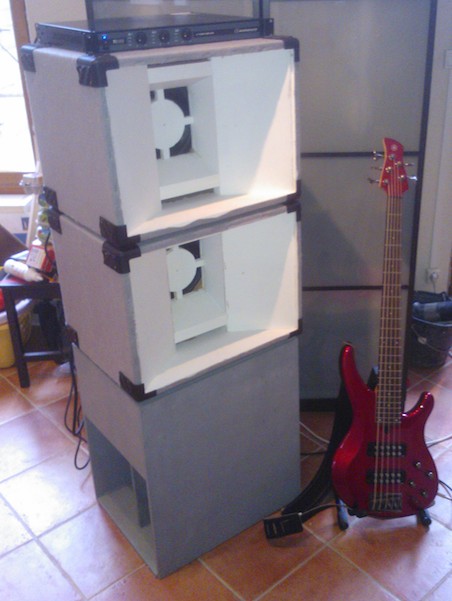

Damn! I knew I forgot something... :wall:
Here is a picture. That's cool because the TAT is exactly the same size as a Jack 10, I juste made it a few inch wider to get at 16".

Ah, there it is! Good for you.
What driver did you use it the TAT?

#6 Post by gosthrider »
I use one 10" Daytona DCS 255, as recommended in the plans. It was quite hard to find but I finally found it in a german online shop.
The 2 jacks are loaded with the deltaII 2510. At first I wanted to put the beta 10 inside since the heavy bass are dealed by the TAT, but I was afraid that it wasn't gonna sound good when I play fullrange at home without the TAT. :conf:

Interesting
What amp are you using? From the pic it looks like one of those 3 channel models with built in crossover..?

Boyd wrote:Interesting
Exactly, 1 sub channel with active filter until 120 Hz, then 2 channels in parallel mode for both J110
