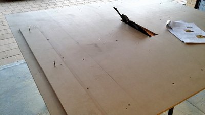

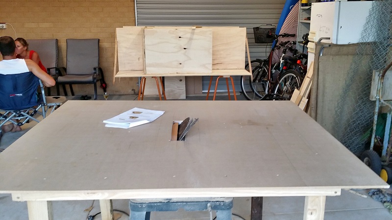

I've had an awesome weekend :-) Started of with building a jig for my table saw to allow me to easily deal with the large sheets of ply. It works a treat, I can have a guide rail for pieces up to 60 inches wide. Nice and easy just measure of a datum that I have place and then screw in the rail. Oh and this was my first ever jig that I've made since this real project involving timber. I decided to make this one up because the table saw I have wasn't really suitable for the BFM supplied table saw jib.

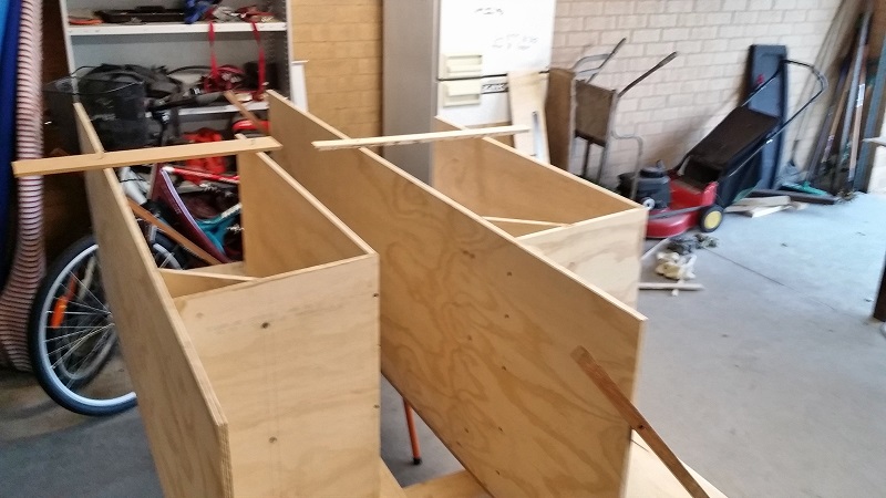

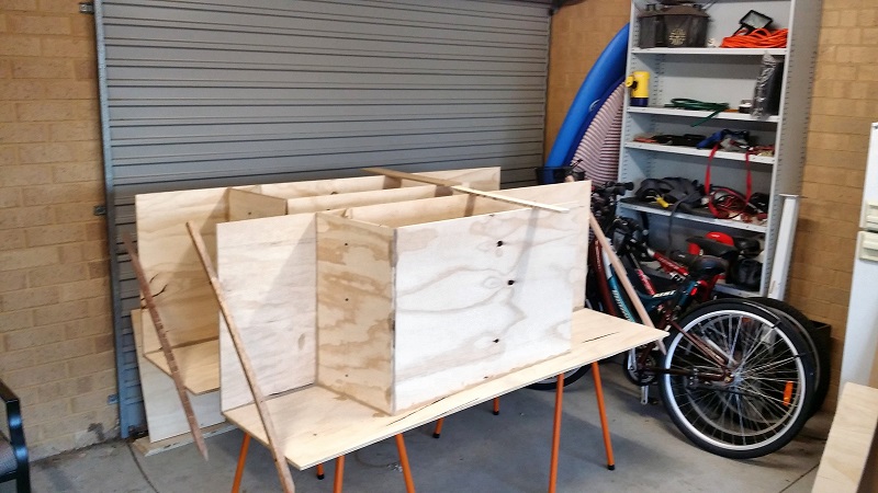

Then I finally got started on construction, Things went well. The plans from Bill are amazing. I spent a good while studying them to get everything clear in my head. Then things flowed nicely. It's also my first time using the PL adhesive. That stuff is freakin awesome. I just wish it was easier to get here in Australia. I got some pics attached of my 2 days work.

That's a large table area!!!
