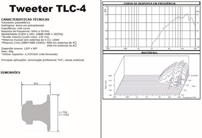

Dear Bill
Since there is no Goldwood dealers or resellers in Brazil I think this could be the only alternative to build BFM speakers with melded array piezos.
Please take a look at the specs. I believe this alternative can achieve reasonable results, but "you are the expert".
If you believe it too, I can send a sample to you for a trial evaluation...

Here goes a picture of the tweeter...

It appears OK.

BillBill Fitzmaurice wrote:It appears OK.
It appears to me as well, but my concern is on the low end response, since it is rated from 5k to 20k @ 108dB sensitivity. According to GT 1016 spects it is rated from 3.5K to 27...although i can see from chart (if it is eliable) that it is pretty efficient around 4K.
Please feel free to raise any comment! Maybe I am completely crazy!
