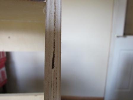

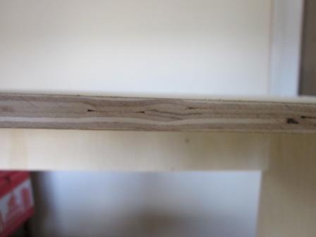

I'm not convinced by the quality of the wood I've got. I'm not necessarily experienced enough to tell what is good or bad, but I suspect that voids and layering such as that shown below are not an indicator of good quality?!!! Am I being over critical, or naive in carrying on using this?
I'm hoping it will be good enough for the XF cab but I may have to look to a different supplier if I start making PA cabs. I'm thinking of using Peter Benson Plywood of Darwen in future as I've seen him mentioned on here and I'm often up there visiting family. Has anybody used Peter Benson and have any testimonials to offer?

That wood is probably OK, but I very much doubt it's Finnish/Baltic Birch, which simply does not look like that. It might have birch outer layers, may even be all birch, but the real deal looks perfect.

That wood IS pretty crap.  You will find worse, but you can also find a LOT better, which is simply a joy to work with!

This is what real BB looks like FYI:

While it may not look the best, I lift my hat to the manufacturers of your ply.
They have used the method of scarf jointing the intermediate layers, which is inherently stronger than butt jointing of the ply layers. Ideally, there would be no voids/gaps in your ply, but it is what it is.
Should be fine for an XF build.
We pay a fortune here as it is for BB/Finnish birch. Specifying it as void free (for any type of ply) increases price significantly again. Still it's a lesson learned before your further builds.
