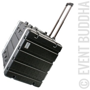

Am also looking into getting another amp for safety, as 4 Lab12s on 1 channel of my iNuke is asking for problems! I am buying an 8U rack in a few days, so that I can put all of my kit in one rack and pre-wire it for rapid deployment ;) The amp rack I am looking at is this one:
Image Image
Although it is 8U, it only has 7U of usable space due to the handle :cussing:
