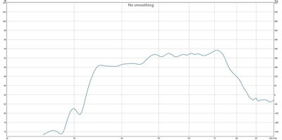

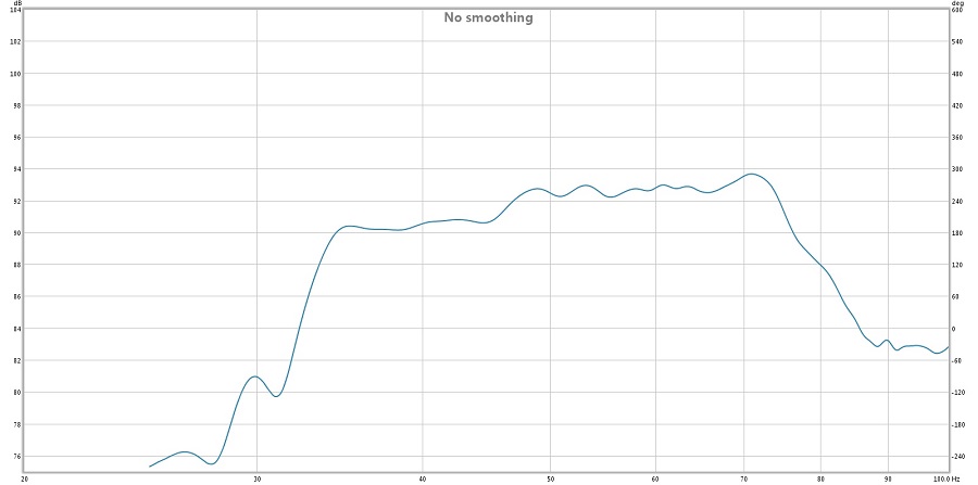

It turns out my room doesn't like <35 Hz :(
See attached. The response has 2 bands of EQ applied via the DCX (cutting at 46 Hz and boosting at 60ish based on measurement in REW) Note that this was done on a calibrated flat microphone.

damn, where is your hipass at?

25 Hz butterworth 48 dB/octave.

loosen up your slope to 24 db/oct. maybe raise it 1 to 2 hz if you plan on slamming 50 volts long term.

I say 24 db slope because 48 is just unnecessary. It offers little extra protection, while it does take away from the low end extension. It can also be a cause of "filter ringing" allegedly, although I cant say I've heard it myself, i will say that after running 48 db slopes on everything (cause moar filter is better right?) for almost a year with t30s, and later t48s, I was very pleased when I loosened the hp filter, and subsituted my 48db lopass for a 24db, or 18 db even.

I also started of with a 48db/oct HPF slope on my T48's. I ended up changing this to -24db/oct, and adding a parametric EQ cut centered at 20Hz, about -12db, and just wide enough not to effect 40Hz (my thoughts being that this would give an initial slope of -24db, approaching -36db/oct at lower freq.
I like the sound of this a lot better.

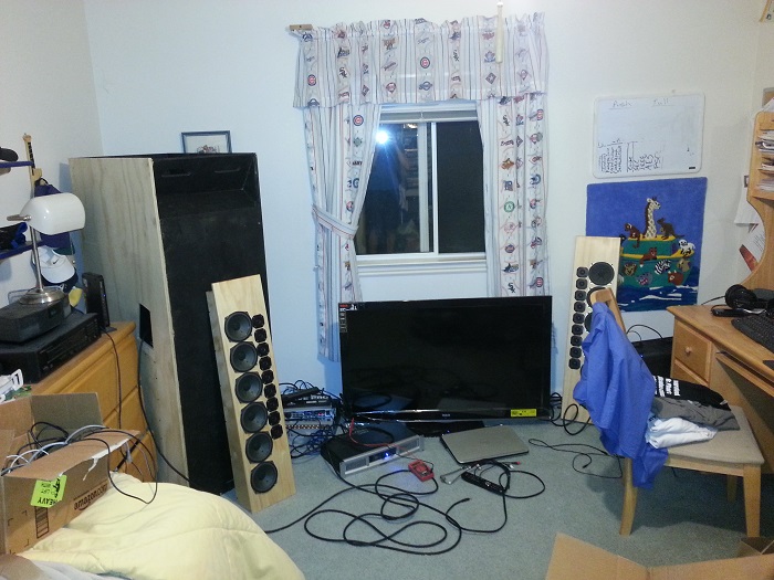

Picture for size reference
