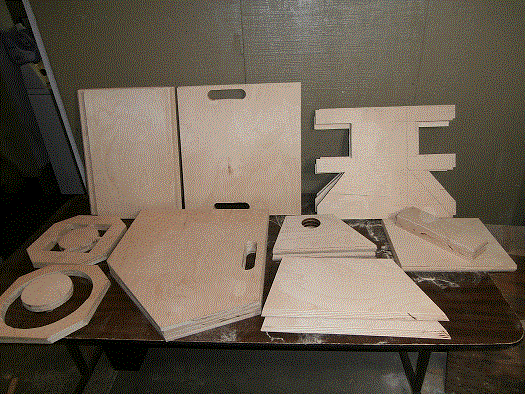

Hello I've cut all the main parts, now to start putting them togather. quick question the plans say:
Install the horn bottom and horn top. Drill pilot holes though the horn top and bottom before installing them, even if using a brad nailer. With brads draw lines connecting the pilot holes to show you where to drive the brads.
But it does not say if I should start using adhesive on this step, I'm assuming "yes" but last time I assumed something I got yelled at :oops: so now I'm trying to follow the plans, please clarify.
Thank you!

Once you've drawn the lines, and dry-fit, then go and add the PL and assemble the horn top and bottom. I'm presuming that you have already attached the throats to the baffle.
