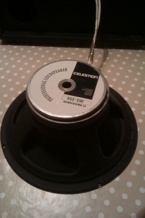

I used to have a Celestion Sidewinder in a DIY cab, a very nice 12" driver. For a while I have thought about building a DR280 bass cab with that, but never got around to it. Still wondering if it would have worked. Cannot find specs for the driver anymore.

The one with the snake on the back and a pressed frame? Nice unit!AntonZ wrote:I used to have a Celestion Sidewinder in a DIY cab, a very nice 12" driver. For a while I have thought about building a DR280 bass cab with that, but never got around to it. Still wondering if it would have worked. Cannot find specs for the driver anymore.

Snake on the back indeed, but mine had a cast frame. It was a black frame though, and could easily be mistaken for a pressed frame construction by an occasional observer. Very solid driver, no lightweight neo magnets in those daysVTypeV4 wrote:The one with the snake on the back and a pressed frame? Nice unit!AntonZ wrote:I used to have a Celestion Sidewinder in a DIY cab, a very nice 12" driver. For a while I have thought about building a DR280 bass cab with that, but never got around to it. Still wondering if it would have worked. Cannot find specs for the driver anymore.
There was a guitar version and a bass/PA version. Mine was the bass version, but have had guitarists playing through it. Sounded "the beez kneez" for warm jazz tones. Not for mega overdriven tones. Celestion received many a request to build them again, but they never did as far as I know.

I got some love. here's the sidewinder guitar version in my bass cab.
