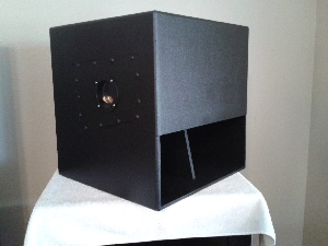

i finished the sub about three weeks ago, and i just could not get it to sound right, and i really wanted to know just how good it could sound. I thought man, i'm just going to hook it up to my La Scalas. Soooo off to the living room i went with t18 in hand got it connected to my Bash 300 amp, and dialed everything in. After playing some music i thought that this little sub sounds amazing, and it's actually keeping up with the La Scalas pretty damn good. Now i am thing that size doesn't matter...(i try to tell my wife that to)

I've been subless for a few months after i sold my THT cab to help pay for repairs to my Hafler 500 amp. I kept the DVC driver for another THT. In the meantime i built a t18 to use with my computer/stereo system in the spare bedroom witch measures only 11x11. I know what y'all are thinking, and yes the sound did suck in there.

. I am impressed that this little sub can sound this good with two fifteen's in the La Scalas. I still plan on building another THT since i have the Dayton woofer, but maybe a narrower cab to take up a little less real estate.

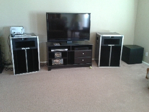

Re: T18 with La Scalas...Surprise Surprise..
Finally got a picture of the T18 with my La Scalas. My son was finally home long enough to help me
I am still pretty impressed with the T18. although i don't turn it up too loud it does a good job filling in. I am planning on starting on another THT next month, gotta few honey do's to do first.
Nice...
Do you have any bigger pictures?
