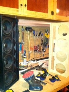

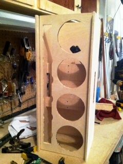

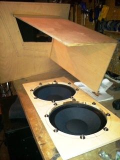

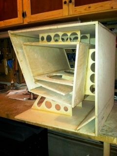

Image SLA Pro under construction. Notice barrel holes for tweeters aren't centered in the array. Swore I wouldn't make that mistake again on the second one. Of course I did. Still not sure how I missed it twice.

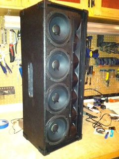

Image One SLA Pro finished, one under construction.
Image Close up of the finished one minus its grill.

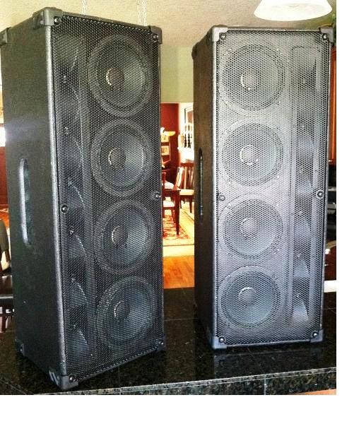

Image The completed tops. I mounted their top hats on opposite ends so when they're on their poles they'll be mirror images of each other.

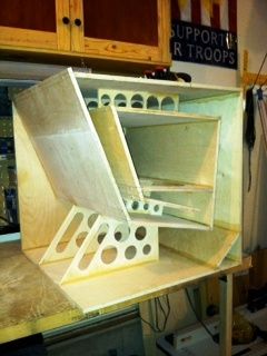

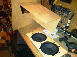

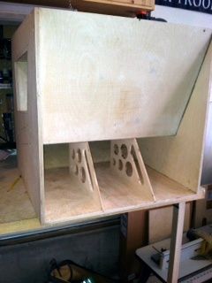

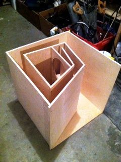

Image Baffle Pic 1 of 2 of a T24 under construction.
Image Pic 2 of 2.

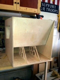

Image A rat maze for very tall rats? Tops were 3/8" baltic birch and the subs were 1/2" BB.

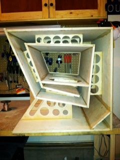

Image Pic 1 of 3 showing bracing. I used leftover 3/8" BB scrap from the tops for the braces. (Plans give the okay for it.) For some reason I had a ridiculously hard time cutting and fitting them. Sometimes its the supposed easy things that can be most difficult. You'll see I cut the classic BFM handholds into the showing braces. Surprisingly useful for wiggling the T24s into position.
Image Pic 2 of 3.
Image Pic 3 of 3.

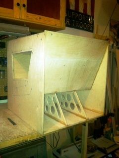

Image This is the second sub. Notice the white horizontal band on the front panel. That's Bondo where I joined two smaller pieces together. Didn't want to buy another sheet of BB ply for one panel. Of course if I hadn't miscut the piece of wood I was going to use, I wouldn't have had to do that.

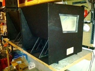

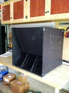

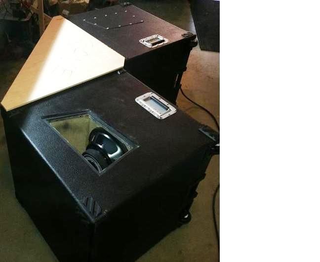

Image The first T24 is finished. I touched up the Duratex after I took the picture. Notice it doesn't have any side handles. More on that below.

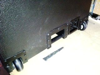

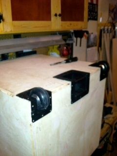

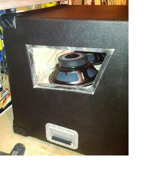

Image As shown on Bill's site, T24's can be stacked mouth to mouth which was the plan all along. But with a dually that's a wider box for one person to get their arms around and pretty heavy as well. So I thought I'd add spring loaded side handles to them to make it easier for two people to flip one on top of the other.
Image The handles are placed so low because I didn't want to put screws anywhere where I couldn't fix a leak if they caused one. Not likely, but it'd be just my luck ... Also didn't want a handle on the access panel.

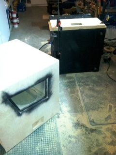

Image Driver chamber prior to adding gasket tape to the flanges.

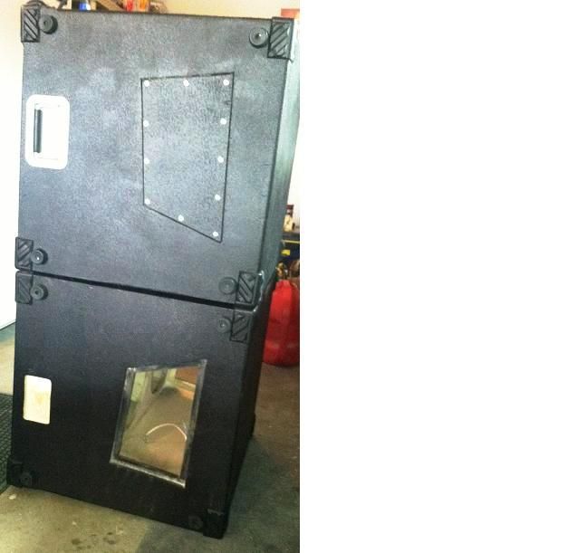

Image A trial stacking. I rounded all the edges except those framing the mouth. I imagine those edges will get banged up a bit when the cabs are being stacked so didn't want to remove any material from there. (Apologies for the large white margins on some of these photos.)

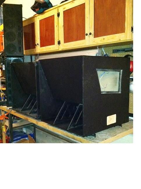

Image Pic 1 of 3 of the Four Horsemen of the Apocalypse.
Image Pic 2 of 3. Yes I know it shows even less detail than the previous one so why did I bother posting it? Because I've read here and there that one can "never post too many pics".
Image Pic 3 of 3. Subs now coupled under (drop down) workbench.

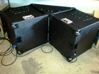

Image Finished! Hard to see but the V coupler is attached to the side of the stack for moving and storage. (And for any Phoenix area residents, that's my U of Oregon Ducks beating up on your Sun Devils in the background.)

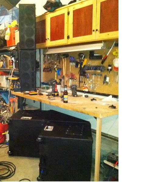

Image Completed subs configured for sound check. I put the Speakon jacks on in such away that when the subs are tipped on their sides for V coupling, the cables of both of them are low to the ground and hopefully less of a tripping hazard.

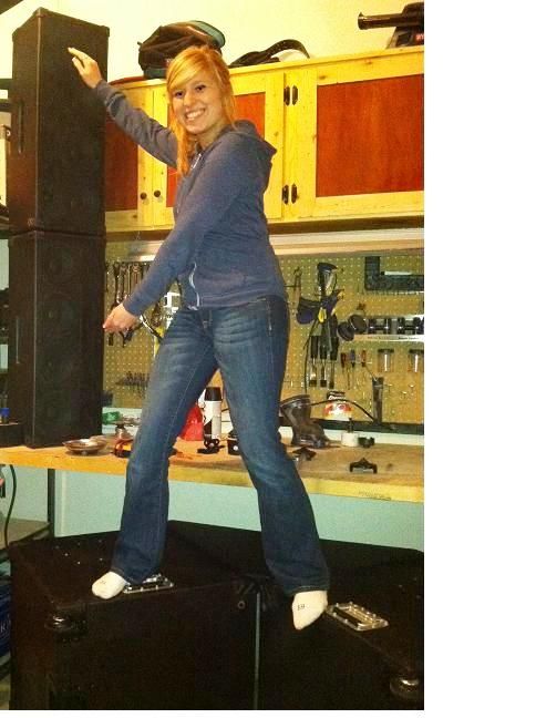

Image Finally(!) my 5' 2" daughter standing on the T24s and playing Vanna White with the SLA Pros in a photo greeting to her brother telling him they're finished. A really great experience all around.
