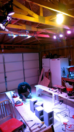

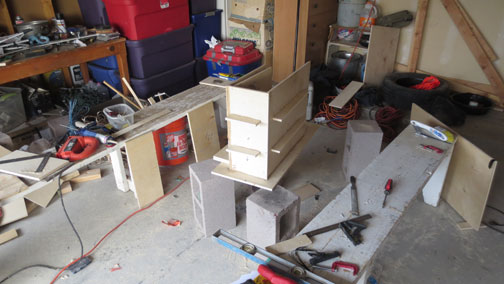

The par can lights helped us on this project.

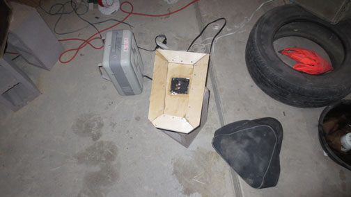

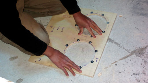

Using el cheap driver as a template
You can never have too much info or notes written on the panels

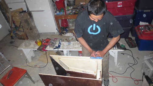

For this build we measured our angles from the side panel with the dimensions so everything is fitted

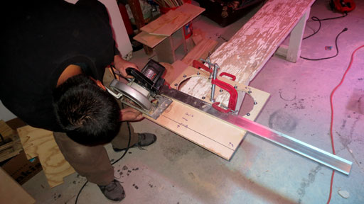

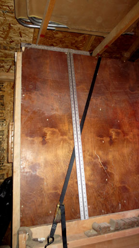

The greatest tool we every bought, a dry wall square. It seems no matter how good we think were are and with all the double checking of measurements, my cousin and I were never able to make 90 degree cuts on the inside panels. This helped us with that.

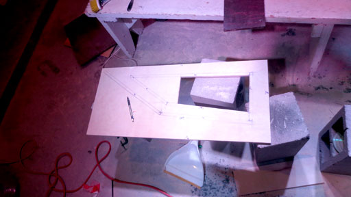

Side panel drawn in
Side panel drawn in

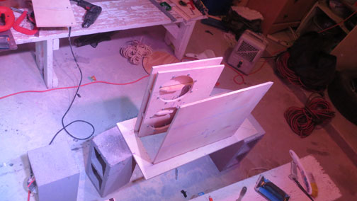

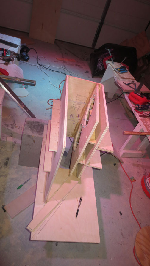

We opted for an non plan assemble of the auto tuba from what we learned from building the tuba 60s. all panels are placed together as pairs with their respective braces. Here panels 2-5 are being fitted.
The rest of the braces fitted
Cutting braces to fit
In out assembly order panel 7 is the last panel to be fitted before capping.

Nice build! A drywall square might be my favorite tool other than a table saw, it squares up panels, acts as a ruler, and provides a bumper to draw lines on all at the same time. 8)

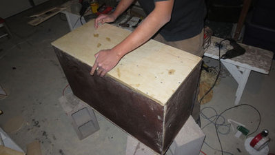

All the edges finally met up but the still was a slight discrepancy in the panels widths. So were sanding the highs down so the side panels fits tight.

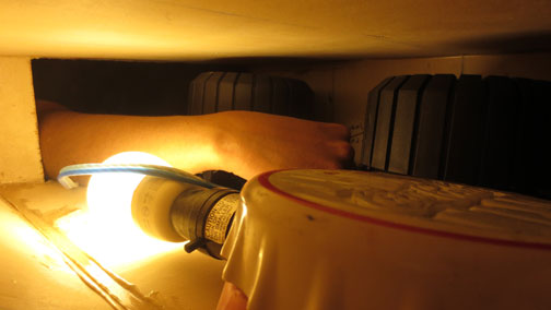

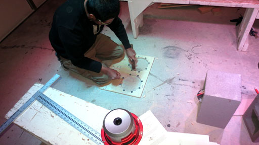

These are not the drivers that will rest in the auto tuba but they will work for now. The depth of the driver ment we couldn’t recess the driver panel. These are Lanzar Max8s

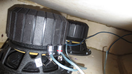

There are 4 ohm svc drivers so were wiring them in series

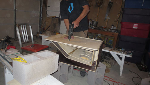

Capping, we check with a finishing nail to so if the screws will bite into the wood, here we had 4 mistakes that required a new screw hole.

Love the PARs for garage lighting! :lol:

Chris_Allen wrote:Love the PARs for garage lighting! :lol:
Indeed, and it also heats up a bit which can be useful this time of year :lol:
