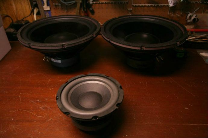

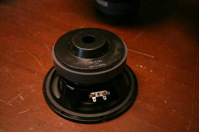

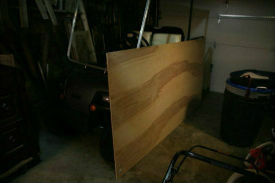

I guess I'm ready to wear some PL fingers for the next couple of weeks. I am building the 13" wide AT with the 8" MCM 55-2421 driver for my son's car as a Christmas present. This was going to be a replacement for a computer sub that blew, but that was fixed with an $8 5" driver I bought through MCM when I ordered the 8. I picked up some 4x8 plywood at HD today for $33. It is not the good 7 layer cabinet-grade BB, but this will do well for this little project. This might move to the pontoon boat if my son is inspired to build something different, such as a dual loaded AT. The MDF is not suited for outdoors, so this plywood will do for now. I have two 30" Titans that I really enjoyed building, so this is as much of a treat for me to build something as it will be a nice gift for my boy. The gift for me is the pair of 36" THTLPs that are coming up after we build this little guy.
Everyone likes pics, so we will start with that:
The stout little 8" MCM driver with the 15" Dayton DVCs behind

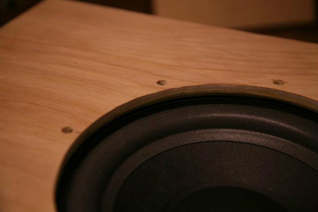

Hole for the driver and pilot holes for the 10-24 T-nuts.
I used a 1/2" routed edge so that I could get the hole for the driver as small as possible without the surround contacting it on excursion. A Jasper jig is on my Christmas list.
Manual range of the excursion shows that the surround is clear of the baffle, so now I'll run a test tone through just to be safe.

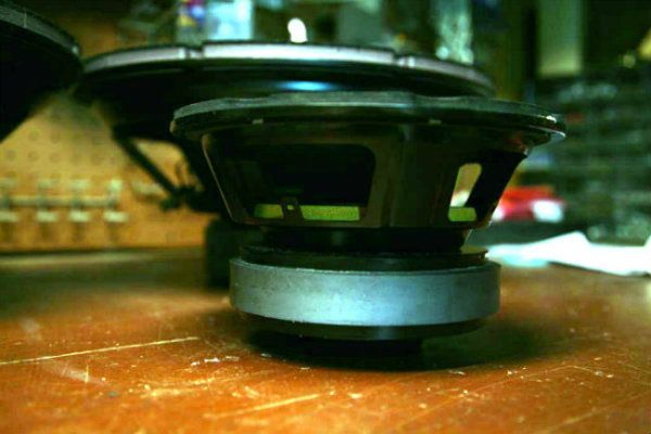

The journey...
Driver space measured and attached
Always my favorite view
