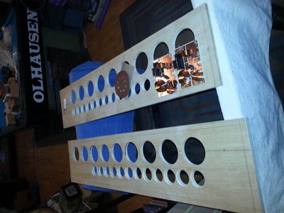

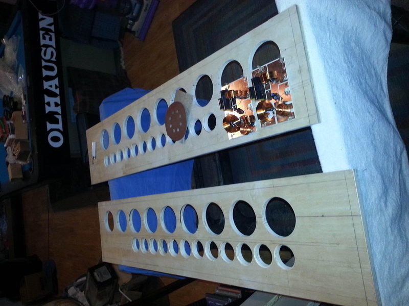

I got a little excited and ordered the 9 speaker/ 12 tweeter kit from speaker hardware. Anyways I'm doing the rectangular version. I was not thinking and made the cuts from the plans.... Woops! Im doing a 9 woofer set-up and I cut my rear panel at 38" and the baffle at 40".... After all that, I think im going to be short on fitting all the speakers in the box. Shit. Did I F up or am I going to be okay? ThanksYall....

My math says I am short. But I want to see if Master can verify.... Or I have to wait until the package hits the door.......

If need be you can add to the length of each. IITP on how to do it.

Hello, i screwed up my first tlah build in exactly the same way :-)
I started over from scratch but i was building the corner mounted version. With the other version the baffle is rectangular so you could indeed lenghten it.

You could splice the panels to lengthen them per the plans or just make new panels.
These get tight already from the description of others so you need the length at the top for the extra woofer.

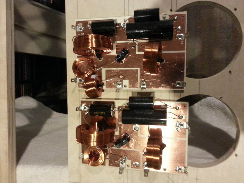

Is there supposed to be one more inductor on one crossover then the other? One has 3 and one has 4. Is this right? I just noticed????? Leland did these and I don't want to look like a rookie if I am wrong/// Thanks guys....

ta_nhra02 wrote:Is there supposed to be one more inductor on one crossover then the other? One has 3 and one has 4. Is this right? I just noticed????? Leland did these and I don't want to look like a rookie if I am wrong/// Thanks guys....
Only Leland can answer for sure. It might be that he had to add two together for the correct inductance, but I'm only guessing.
Re: So I effed up on my first build already.. I thinkTLAH (P
#15 Post by LelandCrooks »
Ran out of 1 value. All of a sudden I sold a bunch of slah/tlah xovers. You can sum inductors just like resistors, so the two summed together are the correct value on that board. I have a helluva time keeping all the crossover parts in stock.
