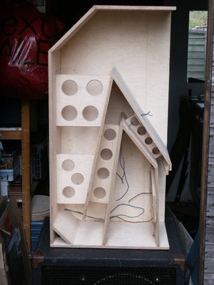

Well, finally, here we are - my first BFM build. These are going to be loaded with some Eminence OEM's that are pretty similar to the BP102-4. I'm building the pair simultaneously, so the pics apply to both cabs.
Day 1's work - chamber completed.

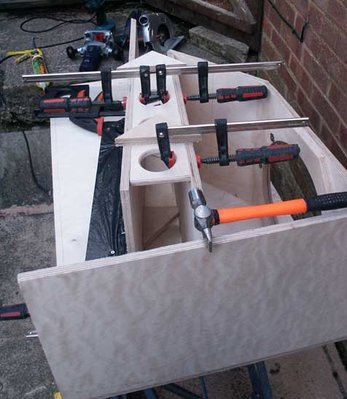

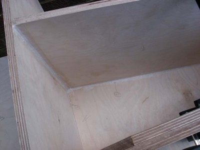

Plenty of squeeze out

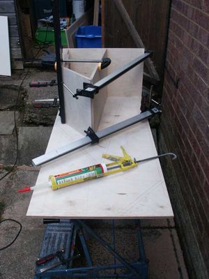

Not all that visible in this shot, but the ply has a really nice figure, almost quilted. Almost seems a shame to cover it up with Tuffcab.

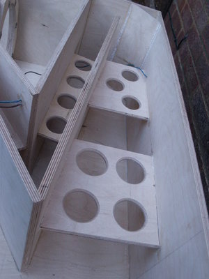

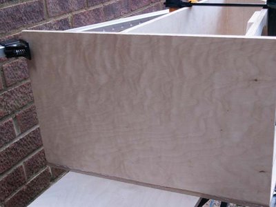

Fixing panel 5 into place, and that quilt again.

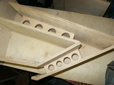

Panel 6 and extension fitted, plus some nice bracey goodness :D

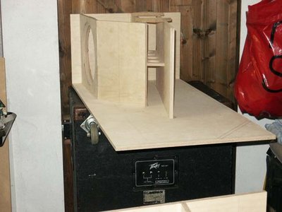

The second cab, sitting on top of the subs they'll be replacing, a pair of 90's Peavey Megasubs.
The T39's take up almost as much volume as the Megasubs (11.4 cubic feet as opposed to 12 for the Peavey) but weigh a good bit less, and will be a lot easier to move about.

Re: T39 Slim x2
#3 Post by Grant Bunter »
Very neat clean build so far :)
Can you tell me why there's only one 3-5 brace though?
With the minimum width cab for a 10" driver being 13", IIRC the plans say there should be one brace for every 6-8" (except for the 4-6 brace), so there should be 2 braces.
It's impossible to change once the cab is finished, and doesn't add much weight wise for 2 braces to be there.
How wide is your cab(s) going to be?

Re: T39 Slim x2
#4 Post by SoundInMotionDJ »
My T39's are 14" outside dimension...and I used a single 1/4" brace in a dado routed into the panels. That is more than sufficient. The brace is 6.5" from either side panel.

#5 Post by Chris_Allen »
I spot a very heavy looking peavey sub.. Nice finish on the ply, is that veneered?

Grant Bunter wrote:Can you tell me why there's only one 3-5 brace though?
Are you referring to the pic with the brace at the top (pic 1 from day 2)? It wasn't fixed there, I was just using it to hold the panel in the right place. The cabs are 13" wide, so they only need the one brace.
Chris_Allen wrote:I spot a very heavy looking peavey sub.. Nice finish on the ply, is that veneered?
Yeah, those Peavey's are a bit on the weighty side. The ply is just standard 12mm birch, it just happens to have a nice grain pattern on the outer layer on one side. As I said, almost seems a shame to cover it up :)

Re: T39 Slim x2
#7 Post by Grant Bunter »
I was referring to the later pic with the brace in situ, but it's all good. I wasn't sure how "slim" your slim was.

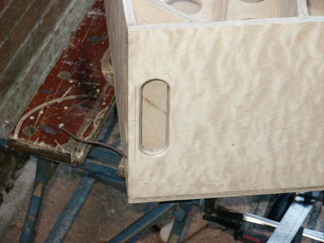

Spot the deliberate mistake... I forgot to add on the 1/2" for the ply when I routed out the back handles. Bugger. Oh well, 3/4" handles will have to do.
