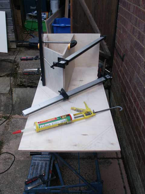

Well, finally, here we are - my first BFM build.  These are going to be loaded with some Eminence OEM's that are pretty similar to the BP102-4.  I'm building the pair simultaneously, so the pics apply to both cabs.

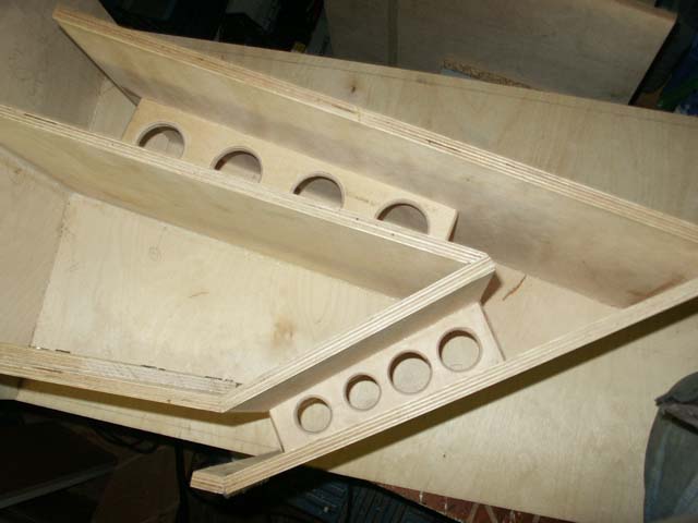

Day 1's work - chamber completed.
Plenty of squeeze out

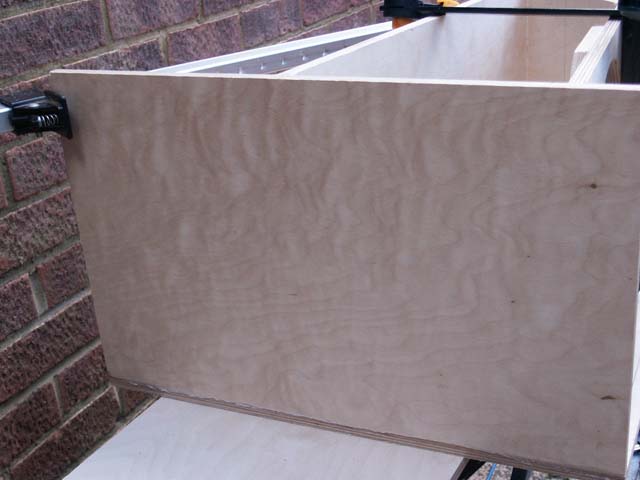

Not all that visible in this shot, but the ply has a really nice figure, almost quilted. Almost seems a shame to cover it up with Tuffcab.

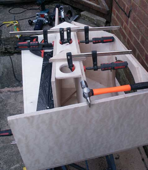

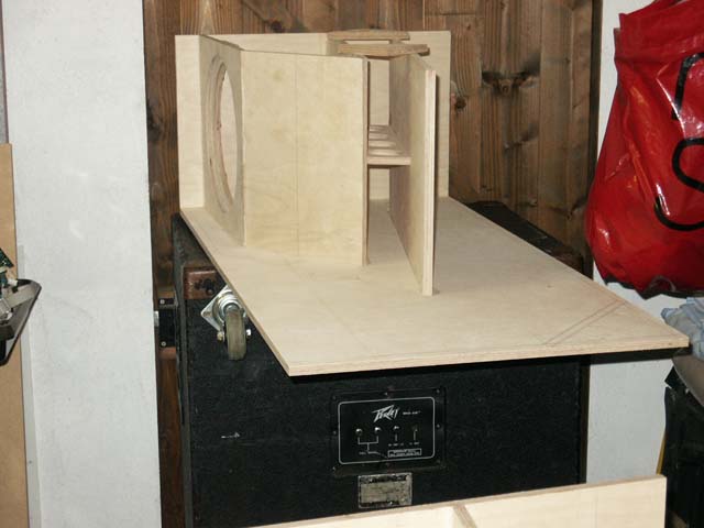

OK, the second day got me to this point.
Fixing panel 5 into place, and that quilt again.
Panel 6 and extension fitted, plus some nice bracey goodness

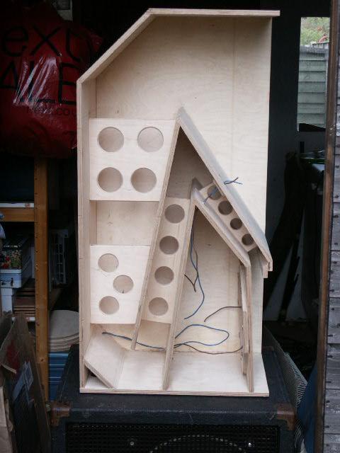

The second cab, sitting on top of the subs they'll be replacing, a pair of 90's Peavey Megasubs.
The T39's take up almost as much volume as the Megasubs (11.4 cubic feet as opposed to 12 for the Peavey) but weigh a good bit less, and will be a lot easier to move about.

Re: T39 Slim x2
Very neat clean build so far
Can you tell me why there's only one 3-5 brace though?
With the minimum width cab for a 10" driver being 13", IIRC the plans say there should be one brace for every 6-8" (except for the 4-6 brace), so there should be 2 braces.
It's impossible to change once the cab is finished, and doesn't add much weight wise for 2 braces to be there.
How wide is your cab(s) going to be?

My T39's are 14" outside dimension...and I used a single 1/4" brace in a dado routed into the panels.  That is more than sufficient.  The brace is 6.5" from either side panel.

I spot a very heavy looking peavey sub.. Nice finish on the ply, is that veneered?
Re: T39 Slim x2
Are you referring to the pic with the brace at the top (pic 1 from day 2)? It wasn't fixed there, I was just using it to hold the panel in the right place. The cabs are 13" wide, so they only need the one brace.Grant Bunter wrote:Can you tell me why there's only one 3-5 brace though?
Yeah, those Peavey's are a bit on the weighty side. The ply is just standard 12mm birch, it just happens to have a nice grain pattern on the outer layer on one side. As I said, almost seems a shame to cover it upChris_Allen wrote:I spot a very heavy looking peavey sub.. Nice finish on the ply, is that veneered?

I was referring to the later pic with the brace in situ, but it's all good. I wasn't sure how "slim" your slim was.Alien wrote:Are you referring to the pic with the brace at the top (pic 1 from day 2)? It wasn't fixed there, I was just using it to hold the panel in the right place. The cabs are 13" wide, so they only need the one brace.Grant Bunter wrote:Can you tell me why there's only one 3-5 brace though?

If the quilted pattern is on all the outer panels I'd be sorely tempted to put a nice clear finish on!

Looks like you did'nt use any screws so far... "natural" finish might be apealing to customers too as opposed to black boxes for weddings etc... if thats your bussiness.Rick Lee wrote:If the quilted pattern is on all the outer panels I'd be sorely tempted to put a nice clear finish on!

+1 those waves would pop like a candyRick Lee wrote:If the quilted pattern is on all the outer panels I'd be sorely tempted to put a nice clear finish on!

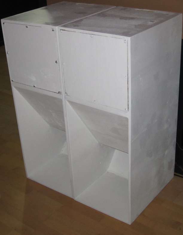

I take pretty good care when moving them...but I see how they could get scuffed easily being white. The nice thing is it only takes a few minutes to white wash any scuffs every now and then.

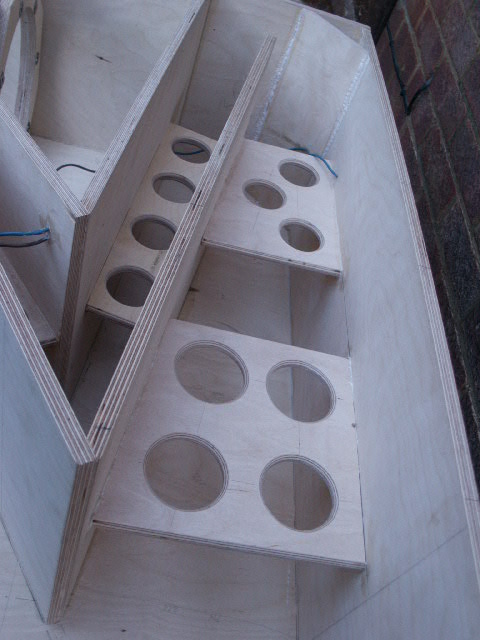

Here's the current state of things:
Back on and braces fitted.
Spot the deliberate mistake... I forgot to add on the 1/2" for the ply when I routed out the back handles. Bugger. Oh well, 3/4" handles will have to do.
All wired up, just a few flanges to go, then the other sides go on
