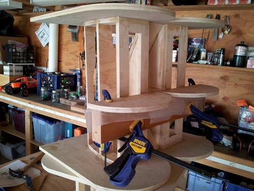

One house move, youngest kid at preschool, I find myself between jobs with a little time to spare. I may be slow but darnit I'm gonna finish.
Not having access to a bandsaw, this is the best I can do. Next time, choose a less flexible saw bit, those edges are far from perpendicular in places.
But there's nothing that can't be fixed by using  too much PL glue, I've been giving it's "gap filling" property a workout. Day is saved.
Took advice to heart after last time.

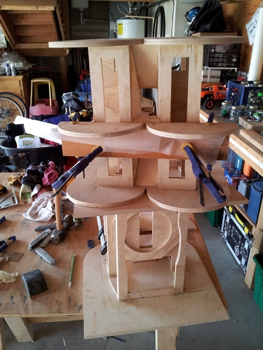

This project is now officially the most complicated thing I have ever made from wood, and we haven't even got to adding the pipe yet.
Still nervous about destroying tweeters but can't stop now. Forwards!
Trying to work out how to split the pipe using the tools I have, got to build a jig. About time I had one anyway.
Way overkill on the screws and glue, just to be sure.
Holes filled and sanded
Front face flush.
Front face flush.
More glue and screw overdose.

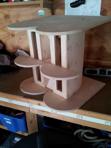

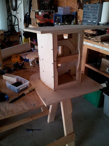

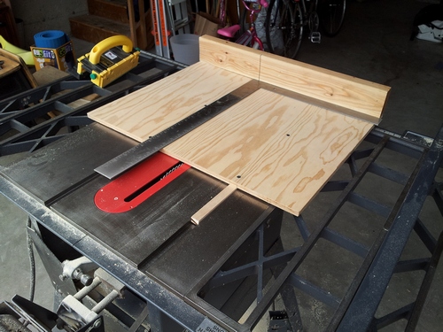

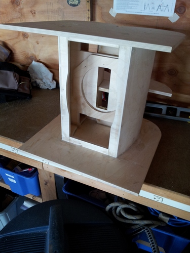

I'm leaving out the entirely scary and dangerous "splitting the Schedule 40 pipe" episode because DAMN do they have some bite on them. Docs fail to mention there are handy lines on the inside of the tube that helps enormously with alignment of the cut. DO NOT forget the 1/8" shim, oh no. Once the pipe is split, the half sections are easy to handle and can be fitted very accurately. Provided you don't trim them too short, in which case you'll be needing to rescue some of the cutoff pieces to shim the large gaps. Smother with too much PL and you're golden (no hot glue gun). At this point the project seems to be constructed of about 87% PL and only 13% wood. At least in my mind.
Been making me some jigs.
Going for a zig-zag layout with a lower blade than in the docs as I really didn't trust cutting through those screws. Now the tweeter section doesn't need to be airtight anymore, isn't this the new style?
Built a jig for cutting the tweeters, and as I have said all along I have probably made every mistake possible. So the cut lines are janky, I had to add a series of 1/8th inch shims to get the cut to the correct place. After finally wising up and locking down the jig to the tablesaw-channel-pusher-thing the results were surprisingly accurate. It looks a mess but the results are spot on. I ran through all the tweeters in one run so I would never have to go through setting it up again. I don't think my old borrowed saw has ever been set to 45 degrees in 30 years. It took serious effort and no small amount of 3-in-1 to get there. Of course now I'm finished and don't need it anymore it works smooth as butter.
DOCS BUG?: Cutting the 45 degree ends, the document says "3-3/8 from the end" but the diagram clearly shows a cut that appears to be 2-3/8" from the end. I went with the smaller cut and the result looks like the SKP and the diagrams.
Money on the floor.
Test fitting, ready for gluing tomorrow.
You have no idea how proud I am of this. The potential for screw up was enormous and I came out (after a little shuffling of drivers) with a full set of perfectly aligned pieces, end pieces correctly aligned and cut on one side and no broken tweeters. It's practically miraculous.
The current state of play, piecing together the front units for the tweeters. I'll wax paper the whole front and build it in place once I work out how to get my head around cutting that 3-degree angle on the baffles. I have a jig now but the visualization is escaping my feeble mind. Thank the creator for the Sketchup reference.
If you are building one of these, here are two tools you will use far more often than you think. Measure, measure, check then measure again. Then measure once more from the other side and finally cut. Then check by measuring.
