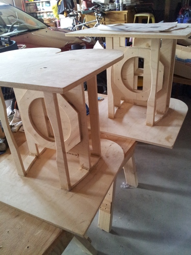

- Step 1 was to build the sawhorses and assemble a workshop. So I'm a little behind already.
- After years of neglect in the garage in the NW climate, neighbors table saw seems to have seized the arbor nut solid so I'm stuck with his old blade. Yes, we tried penetrating sprays and hammers.
- No guide channels on the saw table or angle guide-pusher-thingy either so I'm cutting angles by eye.
- No riving knife so I've had a couple of lessons in sawblade kickback. Nice, purple ones to the gut. Never again.
- Probably cut every angle on the wrong side once, glued pieces backwards, destroyed pieces by screwing too close to the edge, ripped off laminate layers while separating guide scrap, trimmed angles on the wrong side, thrown the part away and started again from scratch. I rock!
- Working without drivers or hardware, I'm getting to the point where I need to buy those to finish the baffles.
- Man, that PL glue is evil in a can.
Following the 2012 designs and I have questions: About that baffle piece, 16" really? There's no way fitting 16" to a 15 5/8" piece like that will give you a 3-degree slope. I guess I'll understand once I get more pieces together but the design so far has some very odd measurements, like the 10-degree horn throat pieces that are joined by a 13-degree parallelogram. Sure, I can fill the gaps with PL, but I don't believe the designs are correct! And then other times they're spookily accurate. It's probably just me, everyone else building these things has no comments.

 That is a frequent, and prevalent observation around here....welcome to the club.  Your DRs are looking great, my friend.  Keep plugging away.
