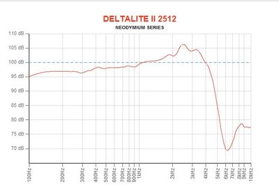

this is for the David Floorstander, so eminence is not involved in this build... but how do i recognise "rising" responce?

#6 Post by Michael Ewald Hansen »
Bas Gooiker wrote:this is for the David Floorstander, so eminence is not involved in this build... but how do i recognise "rising" responce?
This is the freq response of the Deltalite 2512 - see the rising response? :)

but xmax, Fs & vd can be seen as most important for woofers inside horns, with rising responce for mid woofers or am i jumping to conclusions here.
