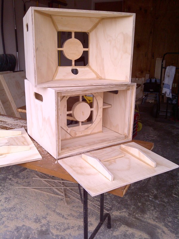

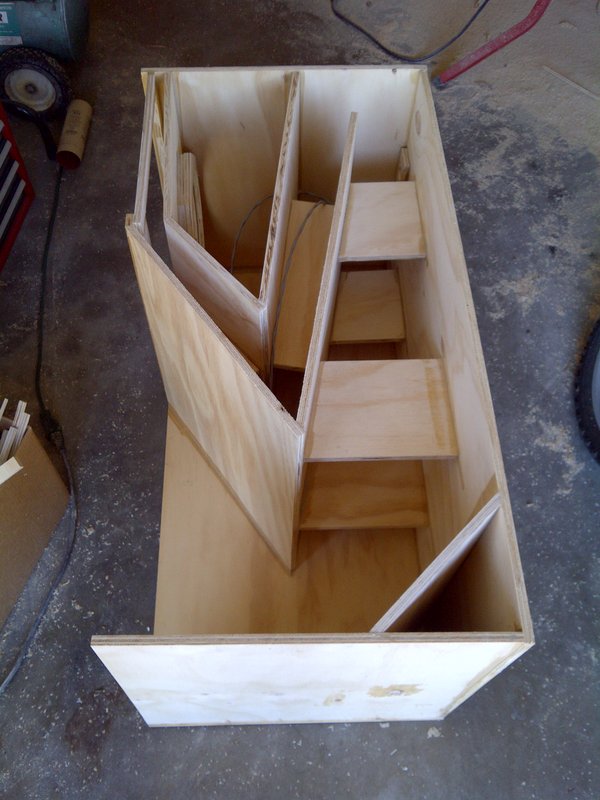

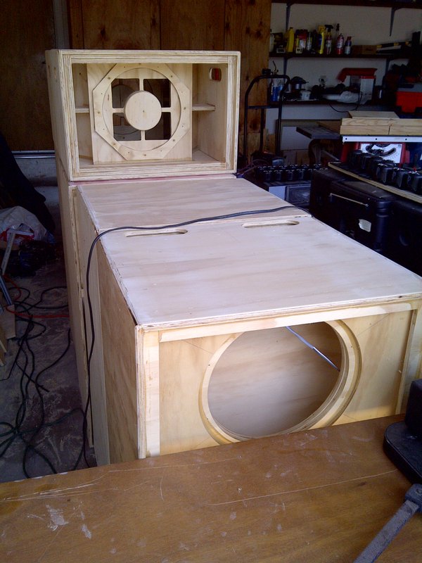

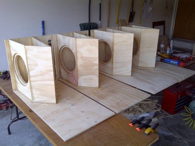

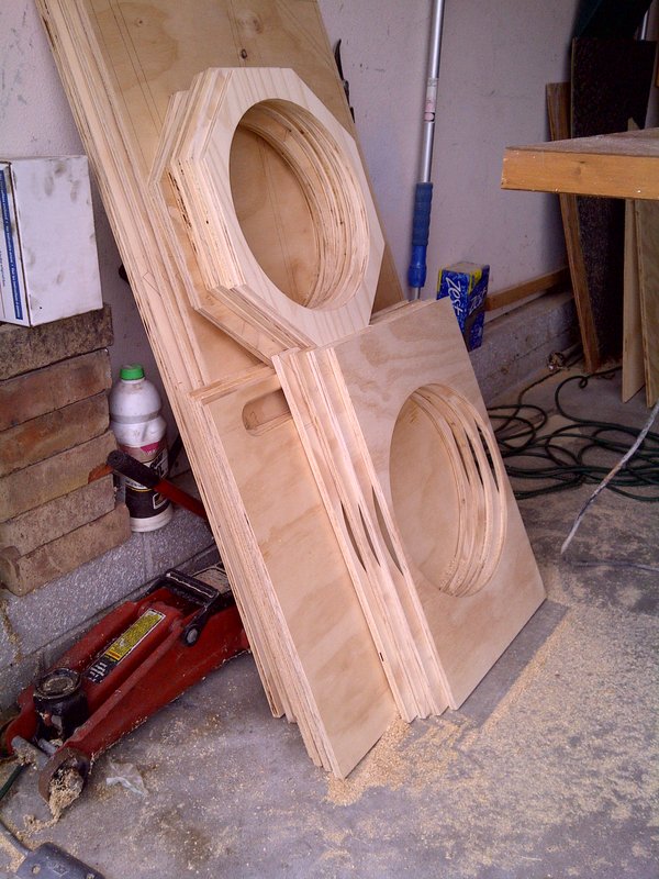

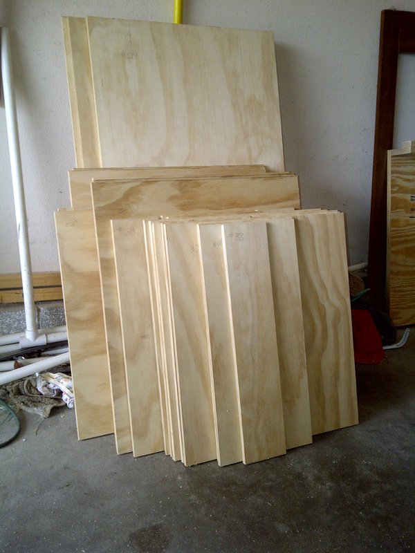

Well, I've lurked the forums for a couple of years, bought plans in January and started building a week or so back.
Started with the OT112s since they seemed smaller and easier to learn on. So far, that seems like a good decision. Got the structural stuff done last week and moved on to prepping the T39s. Assembly starts tomorrow!
Don't have many pix at this point simply because I was too busy scratching my head - plus, I was usually covered in sawdust, PL or both!
My wife has decided that since I'm a "woodworker" now, we can tackle new floors and a few other projects after this saga is complete. Actually looking forward to it, simply because I like this stuff!
Never built anything on this level before and am grateful for Bill's excellent plans and all the support here.
Here's a few shots...

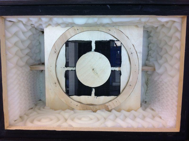

Gee, don't make this so hard....
Just go buy some mattress topper, cut it up and glue or staple it in - it's that easy.
The port holes aren't cut yet in the picture....

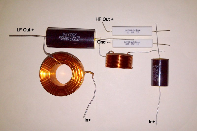

Bolted a woofer in a cab last night to check for air leaks. So far so good. Too hot (105F) in the garage to work today, so I got around to unboxing my crossover components for the OT112s. I've attached a pic of my proposed layout if anyone cares to give it the once-over. You'll just have to imagine the solder joints. I could do the dual-board layout in the plans, but a central location makes more sense to me... for whatever that's worth.

If you could stand your little inductor farther away from the big inductor, it will be better yet. The layout seems right as far as I can chase it.

Should the right side +IN be labled -IN?
