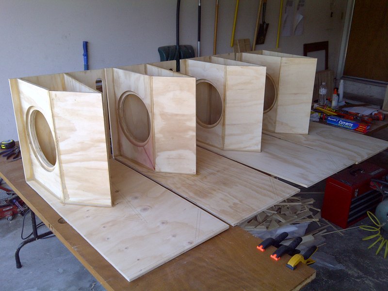

Well, I've lurked the forums for a couple of years, bought plans in January and started building a week or so back.
Started with the OT112s since they seemed smaller and easier to learn on. So far, that seems like a good decision. Got the structural stuff done last week and moved on to prepping the T39s. Assembly starts tomorrow!
Don't have many pix at this point simply because I was too busy scratching my head - plus, I was usually covered in sawdust, PL or both!
My wife has decided that since I'm a "woodworker" now, we can tackle new floors and a few other projects after this saga is complete. Actually looking forward to it, simply because I like this stuff!
Never built anything on this level before and am grateful for Bill's excellent plans and all the support here.
Here's a few shots...
