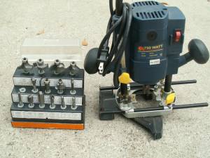

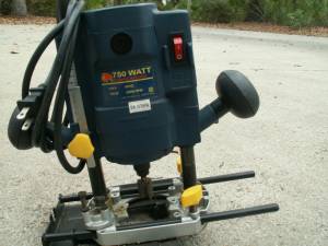

I just got it. I talked to the guy...says its brand new Buffalo, been used once and includes looks like about 14 different bits.LelandCrooks wrote:gone.

Does this one look decent to you?

Donny, that one is 700 watt (mine is 1320, 2 hp) so it is somewhat under powered. It can work if you have patience and work slowly, paying attention to the motor and the bit and how they sound when it's working, ie, not overloading either of them.
I tried to find Buffalo routers but I wasn't successful.

I'm using Dads Makita non plunge router, haven't used them much myself, so, I bought a set with 1/2 and half round over, trimmer bit (and a nice size 45 degree bit I thought might trim up some bearing edges on drums lol). plus about 6 others bit's for less than $30, seem fine.

As suggested, don't try to work too fast due to your lower rev count. That pack of bits looks very similar to what I bought and they seem to go well enough...
