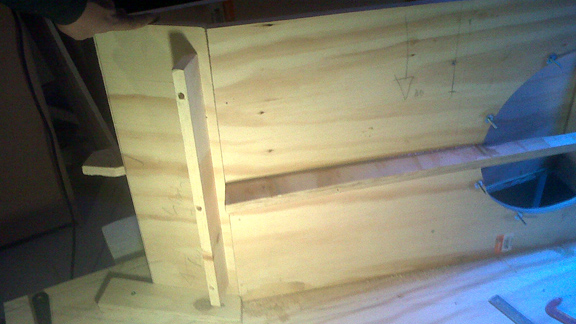

I built two tuba 60’s for my DJ’in Cousin and he used them in few small events (everyone was floored btw). Soon we determined that we could do with two more tubas for future outdoor events. We went on a sleep learning curve with the previous tubas and I’m determined to make this one and all future ones, perfect. All the previous builds we did everything from memory and did not save our plans. So we sat down and reconstructed every little problem we had and annotated the 3rd ones plans. SO this post shall document the 3rd tubas construction day by day in real time just for fun and prosperity. Enjoy :D

Day 2
My quest for perfection ended today but only after each step after step the melting of perfect joints inflated my ego. Each step made sense and everything fit then … Disaster on the last panel. My ego deflated and I sat wondering what went wrong, sitting senseless, But its not an excuse to panic but time to trudge on and proceed while the PL is still wet. :D

Scribing those brace lines across the face of the panels, transferring them up from the side, is excellent technique. 8)

#15 Post by zefrenm »
Woke up late this morning And It was very cold. Today was slow going as most of it was spent on fixing the mistake of the previous night. Mistakes when carefully dealt with can be eliminated and time will repair your ego. :wall:
