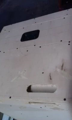

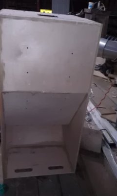

Just finished the first few steps and now i am waiting on glue to dry and then cutting more wood and more of the same tomorrow. I will post pics soon.
bass_maniac5
- Posts: 12
- Joined: Wed Nov 30, 2011 5:44 pm
Re: And so the addiction begins: 24" Titan 48
Now for pictures and any comments or concerns are welcome
