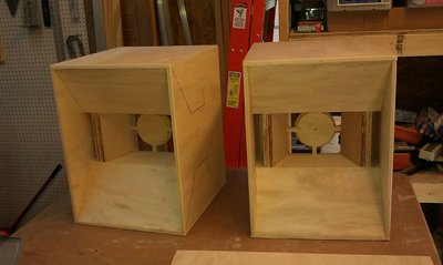

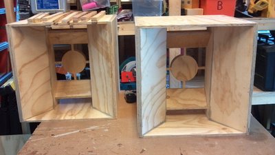

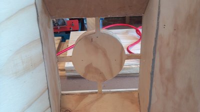

I hope I get some time in the future to work on these. They will be used to tailgate, and during practice sessions on my acoustic/electronic drum kits.

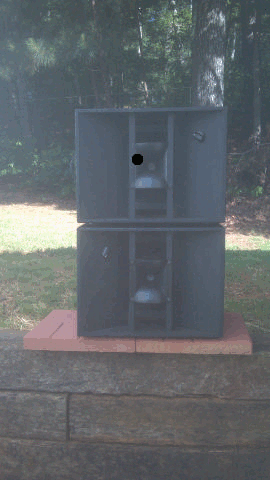

Here is a picture of my mini A7's aka slightly modified Jack 10's. I made a few changes to the crossover based on some measurements. I wanted a go sounding tailgate speaker verses a PA sounding speaker. They sound really great and do a good job when I practice on my drum set. I'm building a pair of J15's to be used with my drum kits.

Got any close up pics?
What tweeter did you use?

The ASD-1001 .... crossed over at 2K (W&T) via a third order xover , I added impedance compensation on the LF side too. I'll post some better pics soon.

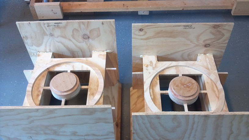

Here are a few of the Jack 15's underway.
