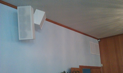

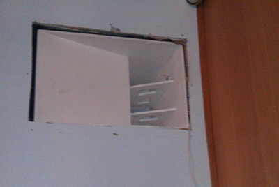

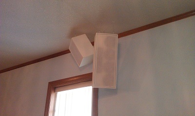

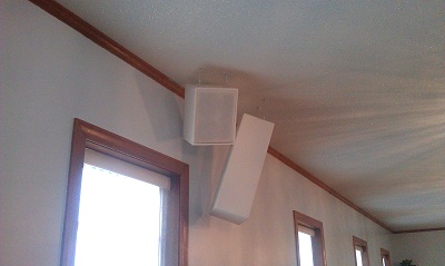

To accomplish these goals, after carefully considering each of the plans on the CD, I chose a pair of SLA Pro cabinets for main speakers, and a pair of half height SLA Pros for stage monitors. The sub is a slightly modified T30 - the height is shortened by one inch to make it fit in an abandoned furnace return duct. I asked forum member Brew to help me with these, as I need to retain the use of my fingers to play the piano, and I have to say he did an excellent job. The finish work is just as good as the OAP cab that came down, if not better. The FOH pair is built with four Dayton PA-6 mid drivers and two Dayton PT2C-8 ribbon tweeters each. The monitors have two mid drivers and four Goldwood 1005 piezos. This arrangement has worked out wonderfully. We finished the install about an hour before Wednesday service. I didn't have much time to tune, but service went on without any major problems. I returned today and tuned the system (only 3 or 4 parametric EQ adjustments were required) and now it's perfect. Even without the tuning, I heard nothing but positive comments... people commented on the clarity and better volume (which I translate to mean "less harsh"), and plenty of comments about the aesthetics (these things matter in a church).
As for the new monitors... the singers had always complained about the monitors being too loud.. this was harshness, not volume. When I turned them down, they couldn't hear. This had to be fixed... the new cabs keep the sound on stage even across the entire stage and choir, and they are EQd to be a little more forward in the vocal range than FOH, making the monitoring experience perfect. Everybody's happy now.

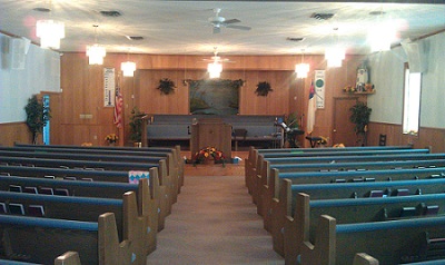

Here's before and after:
Back of Room.jpg (144.08 KiB) Viewed 3131 times
And the individual pieces...
Tony The Tuba.jpg (30.46 KiB) Viewed 3131 times
L Monitor.jpg (99.9 KiB) Viewed 3131 times
R Main.jpg (100.44 KiB) Viewed 3131 times
L main and sub.jpg (101.94 KiB) Viewed 3131 times

Great execution. I assume the duct cover was only removed for the photo. I'm excited for you.

Gauss wrote:Great execution. I assume the duct cover was only removed for the photo. I'm excited for you.
Yes... we replaced the old vent cover (which would have rattled badly) with a fabric frame, visible in one of the photos.

J_Dunavin wrote:Where is the Tuba located in the room?
Anyway beautiful install!!
Looks like in the second photo titled 'back of room' it's in the left corner above the door, pretty much under the left chandelier in the photo.
Look at the last picture, "L Main and Sub" and notice the grill in place above the door. As I mentioned, this was an old furnace return duct, but it the only place available to corner load, and it's worked out beautifully. The bass is nice and even throughout the room, except for one minor 80hz room mode bump in the middle of the seating, which isn't a problem.
