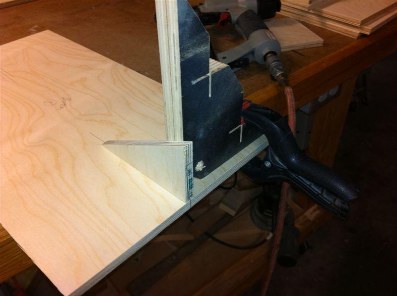

Build you a couple of these....much better than guide boards.
Easy to build. Cut a notch on the back corner and the glue will never touch 'em. Plus, they keep the panels much straighter the a 2 inch guide board can.

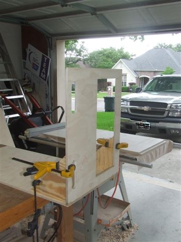

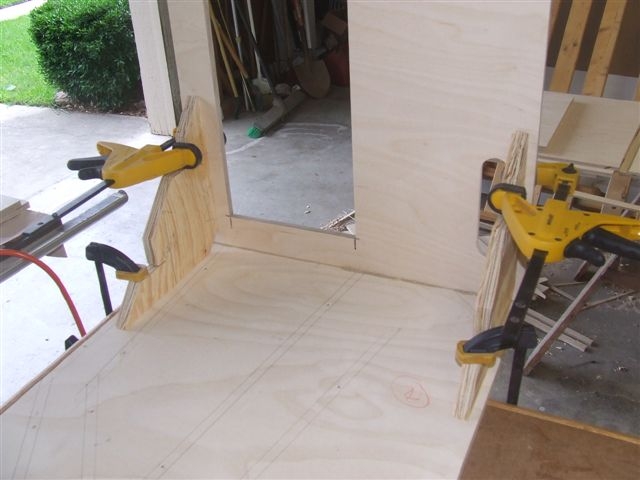

#12 Post by Bruce Weldy »
Tom Smit wrote:Bruce, what do you use for the inner panels on a sub, or, how do you install the inner panels of a sub using the W-cauls? Do you have pics?
Here's the cool part. You don't have to attach the caul/jig to the side (the panel laying down as you build). Just attach it to the upright panel and it acts like a foot. Also, since the interior panels are being attached to other panels - that holds them square.
In fact, after the T39s, I've used 'em many times - and I rarely clamp to the bottom board, just the one standing up. They are very stable just acting as a foot and the weight keeps them from falling over the other way......
Hope that makes sense.
