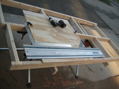

Second is I got a Makita tracksaw over the winter. I am in love. Just make your measurements and place the track down on them, clamp and cut. As for repeat cuts like the panels an adjustable drywall square is my "story stick" as I heard them called, along with a carpenters square. So far so good.
Lastly I gave up my ol foam insulation cutting board and sprung for the BFM panel cutting jig. This thing is custom designed for a tracksaw and router straight edge. I highly recommend building one, along with the Triton MSA-200 you have a easy breakdown system. The Tritons aren't the most stable but if they move, so does the wood, track, and saw so no biggie.

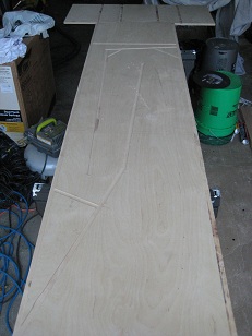

resized 1.jpg (30.99 KiB) Viewed 4753 times
This is the side dado'd out and panel 2 sitting above it.
Here is my new setup. You can see the panel jig, stands for the jig and plungesaw track. Also a joined board
I learned a kickback lesson, when cutting angles with a track saw make sure the track is supported before and after your cut, not necessary with minor angles and 90 degree cuts but a good practice.
