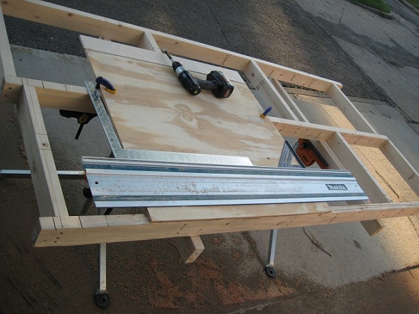

This is the side dado'd out and panel 2 sitting above it.
Here is my new setup. You can see the panel jig, stands for the jig and plungesaw track. Also a joined board
I learned a kickback lesson, when cutting angles with a track saw make sure the track is supported before and after your cut, not necessary with minor angles and 90 degree cuts but a good practice.
Also bought the jasper circle jig. Very handy, I know could have built one but this stores easy and took no time to build. Borrowed a plunge router. Luckily my dads a woodworker so when I need tools I just borrow his, sometimes I give them back too. I will be keeping my eye out for sales on the Skil 1830 router, seems to be the best bang for the buck at my level of building. Looked at it at the local Lowes, solid little guy from what I can tell.
