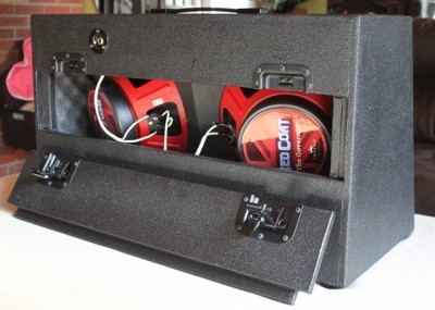

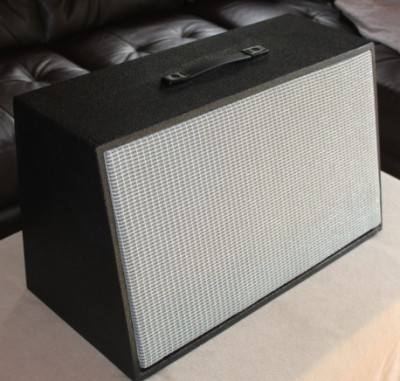

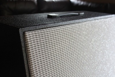

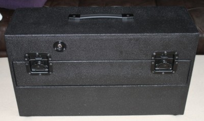

So, I finished my first BFM design! XF212. Black Duratex finish, Eminence The Governor 12" drivers, black and silver sparkle grill (vintage Fender style), convertible back cab.

more pics...
Re: XF212 driver mounting choices
Nice job!
