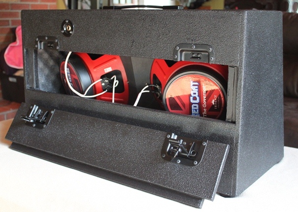

wormtownbass wrote:I'm building a XF212 and I'm getting to the point where I need to mount the drivers.
PICS PLEASE!!!

So, I finished my first BFM design! XF212. Black Duratex finish, Eminence The Governor 12" drivers, black and silver sparkle grill (vintage Fender style), convertible back cab.

#14 Post by wormtownbass »
more pics...

#15 Post by Dantreige »
Nice job!
