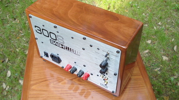

So I decided on getting a THT built, but I am unsure about an amp. I really like the idea of a rack mounted amp over a plate but I am open to either. I was looking at the Dayton Audio SA1000 which is $400 but also was looking at a Bash 500W Digital Subwoofer Amplifier for $240. I can afford $400 but I wouldn't mind saving $160 either, so I am conflicted. I do like how the Dayton also will shutoff and turn back on automatically when being used or not. Granted the power savings would never end up to be $160 in my lifetime. But I am open to suggestions on these or if anyone else has any other options I should look at.

Get the BASH. The 300w version is plenty.

But I guess what I am looking for is if there is any other brands/models I should look at or that also could be rack mountable. If not, I think I will pick up the Bash and save a few bucks.

Ended up ordering the Dayton SA1000. Having the ability to rack mount it was too much to turn away from. Makes it much more conveniente for me to access.
However, though, not really sure why you guys recommend the Bash 300 when the drive can handle the Bash 500 and it matches better.

But in regards to audio, I do know that running an amp that is not pared properly to the speakers can turn out lesser sound then if you match amp properly. I would go with the Bash 500 over the 300 because of that, and it’s just a few bucks more. But I do trust you in saying that the 300 will work just fine. It’s not all cases that having a underpowered amp will create lesser sound from the driver. All in all though, I was more interested in another rack mount amp cheaper then the SA1000 but I think I will be happy with it.

On topic, The reason the Bash 300 is sufficient is because:
1) after 100 watts you only gain 3dB for every doubling of power, until power compression sets in.
2) you will do structural and hearing damage before you get to the Bash 300's peak.
3) if you really want more noise, you need to add cabinets and mouth area.

Earlier in this thread Bill recommended the BASH 300. What about a couple Daytons below? I like them because they have continuous phase adjustment, but haven't used either brand
http://www.parts-express.com/pe/showdet ... er=300-813 Dayton 230External 85 dB S/N
http://www.parts-express.com/pe/showdet ... er=300-807 Dayton 500 Plate 98 db S/N
http://www.parts-express.com/pe/showdet ... er=300-750 Bash 300 Plate 105 S/N
The Dayton's have 0-180 phase adjustment. The Bash has either 0 or 180 phase. Otherwise the Bash seems to be better based on specs alone. I see a lot of people using Behringer Europower amps, but those seem completely overpowered so I can't figure out why.

Thanks for the fast reply. I've been looking around some more and found the O Audio 300W Bash amp. It's similar to the Bash amp at PE, but has continuous 0-180 phase adustment. http://www.oaudio.com/300W_SUBAMP.html I think I'll probably go with this one. They have a 500W for not much more, but I don't see any reason to get it other than "just in case" I plan to swap it into some other future project.

I know that because these subs have such great efficiency it is recommended to go with a low wattage plate amplifier, but i'd rather not have a plate laying on the floor or fabricate a box for it. Can you guys recommend an external amp for a THT that isn't overkill and has a simple face design that will fit in with my other components.

robbbby wrote:I know that because these subs have such great efficiency it is recommended to go with a low wattage plate amplifier, but i'd rather not have a plate laying on the floor or fabricate a box for it. Can you guys recommend an external amp for a THT that isn't overkill and has a simple face design that will fit in with my other components.
Behringer A500. It does not have a lowpass filter though.
