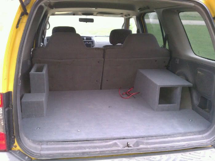

I got the drivers the other day and picked up the last of the supplies today. Hopefully with the lessons learned from my first THT build a couple months ago and the best piece of borrowed equipment ever - radial arm saw circa the 1970's :twisted: - this build will go more swimmingly than the last - plus this time I'll be outside and not in the basement.

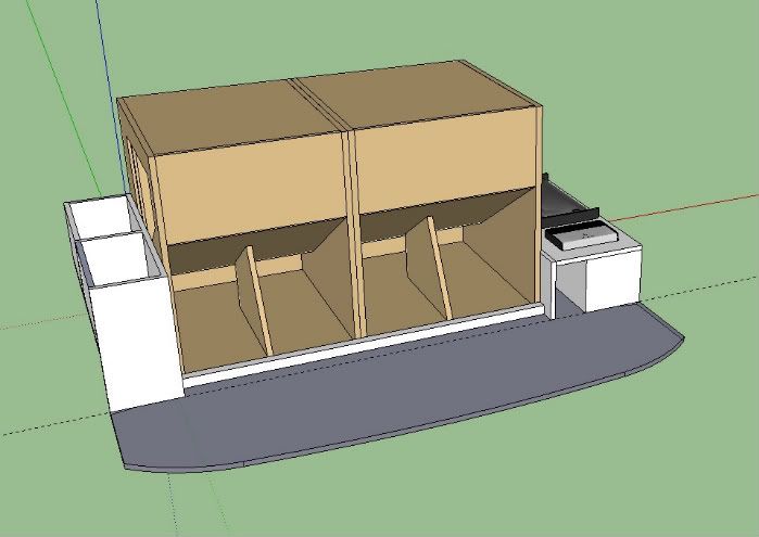

Unfortunately, once decided to start building and bought all the materials the weather took a turn to the cold/rainy/windy. The next 10 days (and previous 5) are supposed to be one or two of those scenarios so the progress will likely be slow. I've spent the last weekend building their new home in the back of the Xterra. Two 16.5" TAT's should slide in with almost no room to spare side-to-side! (Test fits confirm they SHOULD just fit, Sketchup agrees)
Of course, plans change when you realize what you drew up from memory one day doesn't quite match what the interior is really like... :lol:
Replaced the carpet with a solid MDF floor and added storage for the first aid kit and trailer hitch/tow straps as well as a shelf for the amp and crossover. The TAT's will be held in place by the sides as well as brackets in back and a decorative lip bolted to the floor that rests over the front lip of the mouth.

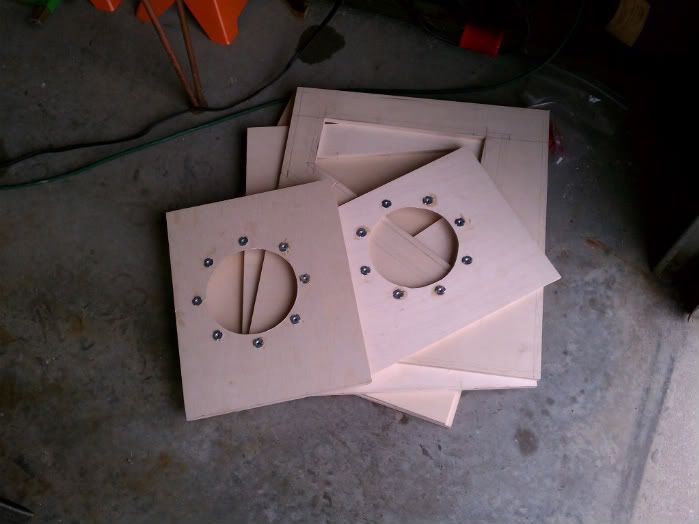

I've cut both sets of side panels and sketched out the lines on all 4 - plus cut out the access cover holes in two of them. (Pics shortly)
Next up, the driver baffles! (Provided when I get home it's not raining...)

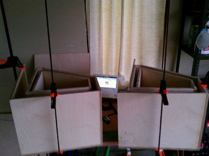

Got some more done tonight. Progressing nicely although even with the radial arm saw it's a challenge to get straight cuts. I mean cuts off by less than 1/16th inch. Maybe I'm just being too picky.

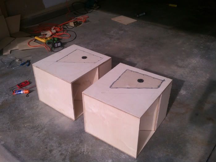

Got all done with the assembly today. Just need finishing touches. I totally screwed up and forgot to make one of the two a mirror image of the other since they will sit side-by-side. :wall: :wall: :wall:
The only way they will fit in the truck now is if one is on its back - or I do some major surgery on one of them. I picked the easy way out. :slap:
At least they fit inside perfectly.
Any real issues with having those set up that way? I would think being so close together it would be alright.

I don't understand why they can't be side by side even if they aren't "mirror image".
Can't you still face them both to the back still? The horn mouths won't be lined up, but I would suspect that would matter even less than they way you have them pictured above.
