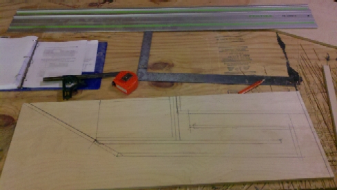

I started builing cabs as a young teen. Copying EV and Sure stuff mostly. A friend of mine called and told me I had to come over and hear his brothers new speakers. I rode my 10-speed over to his house, parked it in the driveway next to the Gran Torino and was ushered into to inner sanctum. What I saw blew me away. At the time I had no idea what a Klipschorn was but I found out in a hurry. From that day to this that sound has been my quest. Ewetho and I have been building cabs for my PA and SLAs for home theatre and they have been great. I still want a set of Klipschorns...or so I thought. I started looking at the David and decided to go for it. The numbers look great. Maybe I can have that Klipschorn sound after all.
I have been looking forward to starting the build all week. Ordered the plans, got my BB, my order from GR Research came in ... just need my PE order ... D@#MN IT! I never placed it...better get that done. 'Gonna build all day Saturday .... nope! it looks like I'm working all day Saturday... well there's always the evening. Get home with the BB and expectantly set up the shop. Say "Hi" to the wife and off we go.....not so fast. She is lonely and needs some attention. What to choose, both are vital components of my home entertainment system. I choose both. "How about we talk while I lay out the cut and assembly lines?" "OK" she says. I love this woman. (Those of you who came to the listening party met her. A guy like me couldn't ask for a more supportive spouse...and no she's not looking over my shoulder right now either.) I am laying out the side after trimming the panel square. We're (I mean she's) talking. I look at page 3 . What is the dimension for the cut out for the mid tweet section? What am I missing ....it's not in the plans...check page 4...not there either...she's still talking... check page 3 AGAIN ... what am I missing? How do I locate the cutout for the driver and the cutout for the mid section wings...she's still talking ... wait what did she say? ARGH What am I missing? What did she say? "Look further in the plans and use the length of panel 5 won't that tell you how to mark the cut length for the owings on the side panel?", she suggests. Genius! That will fix my location issue on panel 3 as well. I love this woman. (I better check on the forum just in case before I make with the saw dust. So... is this correct? I don't see any was to properly locate panel 3 and the cut length on the side panel for panel 5 in the plans.. am I missing something?) Well we got a side panel marked. Let's go inside and watch a movie before bed.
I would like to be sure my marks are correct before I start cutting tomorrow.
"BaronVonSteve"
Posts: 7708
Re: David - Just For Fun
#2 Post by Tom Smit »
The length for panel #5 is on page 8, so yes, she's right. As for panel #3, the diagram in the middle of page 3 shows the basic dimensions for the side panel cut-out. That gives you the placement line for panel#5. With panel #3 cut to length, place it's "top" end on location, and then put the "bottom" end on location measured from panel #5 location.

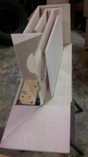

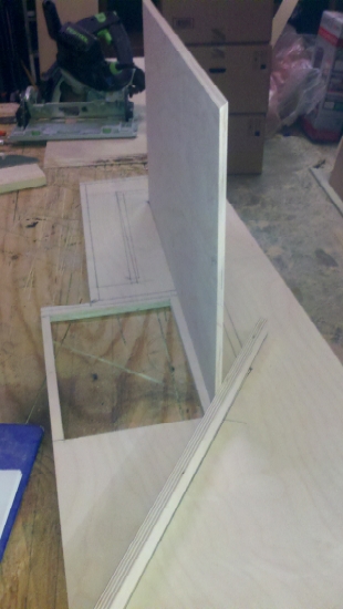

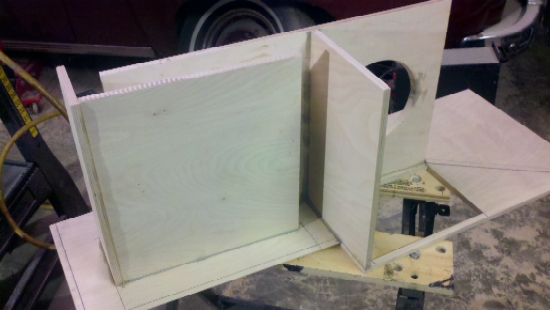

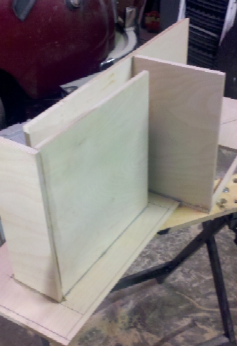

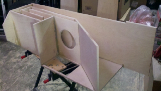

Just got out of the shop. What a fun day!
Here are the pics.
:hyper:
"BaronVonSteve"
Posts: 2077
#12 Post by Radian »
You guys get these up and running, I'm going to have to come down for a listen! :hyper:
Don't forget to build two - :lol: j/k
Posts: 7708
#13 Post by Tom Smit »
Wow, that is one skinny section at the access cover! Even when I looked at the plans, I didn't realize the size.
Good lookin' build so far.
