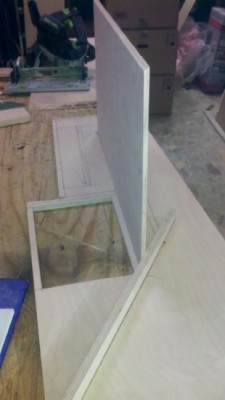

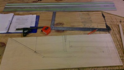

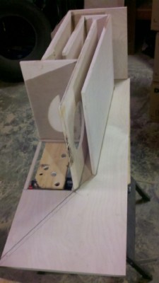

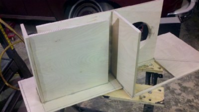

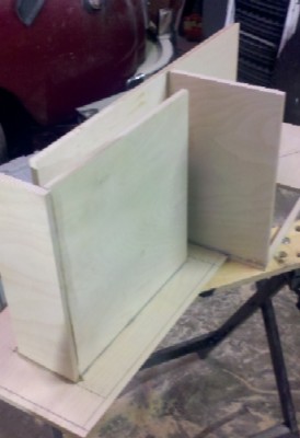

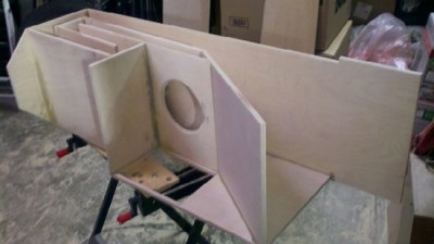

Re: David - Just For Fun
Just got out of the shop. What a fun day!
Here are the pics.
Here are the pics.

Wow, that is one skinny section at the access cover! Even when I looked at the plans, I didn't realize the size.
Good lookin' build so far.
