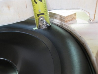

Graphite wrote:I understand gasketing is important in keeping the baffle airtight, what are the best ways people are getting this accomplished? Not only that, but is the excursion of the driver going to make contact with the bracing installed without a huge gasket put into place?
Thanks again!
The gasket is very close to the cast baskets' lip, but once you tighten it down (in a criss cross pattern like an engine head) it's airtight solid. The gasket tape or even a quick bead of silicone around the perimeter (make sure to cure before sealing the chamber), eliminates any question..
