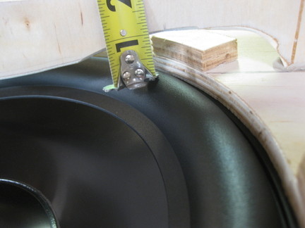

I was looking at myn's Tuba HT build, and noticed the speaker gasket on his sub is HUGE on the face side of the basket. I noticed the gasket on my dayton is non-existant. I was able to find "speaker gasket" material through PE, but noticed it was 1/8" thick. While the speaker myn installed had a gasket of what looks to be about 1/2" thick.
http://www.parts-express.com/pe/showdet ... er=295-468 is the sub recommended for the tuba ht. Notice there is no gasket on the face of the basket.
I understand gasketing is important in keeping the baffle airtight, what are the best ways people are getting this accomplished? Not only that, but is the excursion of the driver going to make contact with the bracing installed without a huge gasket put into place?

Use speaker gasket tape, which PE sells. The plans call for notching the braces where the surround otherwise might contact it. It is odd that the driver doesn't come with a gasket. Many Eminence drivers come with two, just in case.

The gasket is very close to the cast baskets' lip, but once you tighten it down (in a criss cross pattern like an engine head) it's airtight solid. The gasket tape or even a quick bead of silicone around the perimeter (make sure to cure before sealing the chamber), eliminates any question..Graphite wrote:I understand gasketing is important in keeping the baffle airtight, what are the best ways people are getting this accomplished? Not only that, but is the excursion of the driver going to make contact with the bracing installed without a huge gasket put into place?
