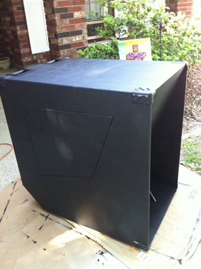

Here is a pic b4 I delivered it. Just 2 coats of primer as he is gonna use bedliner on it himself.

picked up mx882 + dcx2496. charles chase hooked me up with a sweet duratex job.
i resized the pic like 10 times and it says its too big so too bad for you guys
i finally got everything hooked up and time to actually turn it on without disturbing too many people. the dcx2496 is a beast, and for someone like me who has grown fond of turning knobs and pushing faders for the past 15 years, its challenging. i have a very basic setup running LH LH LH, output 1 goes to channel 1 of a RMX2450 to power the tuba. output 2 goes to the other side powering 2 x yamaha club 15"s. to start , i have the xover point set at 100hz. the yamaha's can go lower and are 'punchy' enough, so i am thinking about messing around with the settings a bit.
