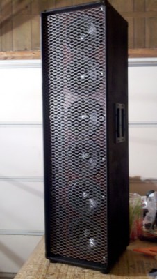

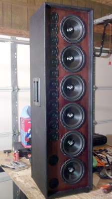

Ever like the sound of the SLA more than say an OTop? Ever like the idea of making one for DJ/PA use but how do you pole mount a TLAH Pro?
How about a SLA DJ/Pro.....
It actually sounds just like the SLA only MUCH BIGGER and Louder with upwards of 750 Watts RMS power handling.

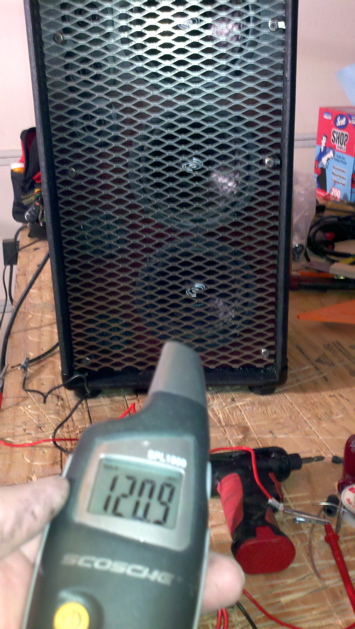

We built this one and has been tested to 75 VOLTS input and found above say 400 you get so little except it starts to get harsh up top in the Tweets. But over 120 DB at 1 meter has been measured a couple of places (NO not done completely outdoors yet but...). It was unveiled at our Listening Party yesterday and received very well. Most thought it sounded VERY GOOD!!!
The only down fall compared to OTops is that it requires a bit more juice to get the volume all the way up but it sounds effortless and very VERY Clean like an SLA should. Best of all we left room for POLE Mounts. Been kind of thinking 2 of these and 4 Killer Bees (Double loaded T24s) as a complimentary set.
Since the picture we added the obligatory grill.<br /><br />Show Pictures forthcoming....

Very nice! Which drivers are those?
Drey Chennells
Posts: 1377
Re: SLA DJ/Pro style
#3 Post by Drey Chennells »
looks like pyle pro 6.5 for mids?

True Bill I would not argue that a TLAH Pro would not be a truly more capable design but packaging sometimes can be a consideration. The ability to pole mount these is very Nice.
Porting was in an attempt to tune for the drummer as a monitor. But past a few feet is really transparent and when crossed over at 100 does not effect the sound at all.
The drivers are a PDMW6 Pyle Pro for woofs and 12 Goldwood GT-302 tweeters.
$185 in supplies.

Couple more pictures
How about some measurements....
Here is a decent pic with the grill.

nice. what do you have crossing them over and so forth. what are your cabs specs?
InfraCoustik
Consulting/Design/Fabrication
Authorized BF Builder
http://www.infracoustik.com/
info@infracoustik.com
ewetho
Posts: 462
#15 Post by ewetho »
Basic cabinet specs are above and the cross over point is 4K.
