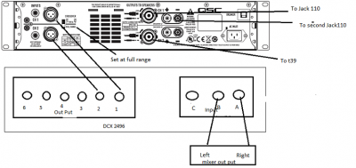

Finally I got alll my gears together to try out my first built pairs jack 110 & T39
First: which is the recomended way to hookup from DCX2496 to one GX5 (one chanel to the Jacks one to the T39)? this can only run in mono right ?
Second :If I'm using 2 amps, one to power the Jack another to the T39 how should I wire this up ?
Third : What is the crossover Switch position full range or crossover ?

Mono input left channel on the dcx. Then the lows to one channel and the high's to the other one. Full range as the dcx will take care of the processing. Then you can connect one cable for the Jack to the speak-on and one to the banana plug on the same channel or use a splitter for either of those, or bridge from jack to jack (it works but it's better if the cable was only a couple of feet).
If running two, you can then run stereo. simply do R-high on one channel of the smaller amp and L-high on the other channel (you could then run four tops), and then just add the subs on the other amp.

Thanks you so much SeisTres
Is this what you mean if I use only one amp.

mino00 wrote:Thanks you so much SeisTres
Close....
You should sum the L and R output of the mixer by making a Y cable so that both signals come out of one connector in mono. Either that, or just run the left or right side and pan every channel that way. Y is better.
On the amp speaker outputs - Don't run one jack off the Speakon and one on bannana plug. Just run from the Speakon to the first Jack, then daisy chain to the other one (use the parallel speakon jack on the speaker to run to the other speaker).

Bruce Weldy wrote: You should sum the L and R output of the mixer by making a Y cable so that both signals come out of one connector in mono. Either that, or just run the left or right side and pan every channel that way. Y is better.
No no no. When you make a y cable what you're doing is driving one input into the other. Is it not AT ALL like splitting where one output is driving both inputs. If you must combine, a direct box or a "mixer" must be used, not a y cable. Y's are for splitting, not combining.
Bruce Weldy wrote: On the amp speaker outputs - Don't run one jack off the Speakon and one on bannana plug. Just run from the Speakon to the first Jack, then daisy chain to the other one (use the parallel speakon jack on the speaker to run to the other speaker).
Why not? The down side here is that the first will get slightly more power than the second as the second cable will be piggy backed onto the first and adding further resistance. It's doable and it really won't be all that noticeable, but just to keep everything optimal, splitting right from the amp is best. If you cannot, then don't sweat it. Since this is how I run my set up most of the time, I actually built a speak-on splitter from some jacks and a little project box from mcm. Works perfectly when I don't want to use banana plugs as the powered mixer does not have them. The other plus side of splitting right from the amp is that your wires can be shorter if you place your amp in the middle. The real down side, though, is having to deal with banana :(
As I do not have a dcx, someone else will have to chime in, but if you can combine the stereo inputs with the dcx then the way you have your diagram is perfect. However, if you cannot, once you send a signal to the R input, it will make everything stereo, so everything on the Right channel will not be played if the dcx does not combine. If this is the case, then you must combine outside.
What are you using as far gear to kind of get an idea how it will be good to combine if the dcx cannot do it?
Uh.....an input into an input? If I turn it around, am I sending an output to an output?...Fellas, it's three connectors with common wiring - they are all paralleled. The signal is "seen" the same in all 3 places. It is the simplest of cables - I build my own....have run 'em for years. My PA runs with the L/R Yed to the input of the DRPA. The church system I run is wired this way to run mono from both outputs (it was this way when I took over). This is not unusual. Nor wrong....it insures when running mono that if a channel accidently gets panned the "wrong" way, you still have signal. Can't do that with using only one side. I wouldn't do this trying to combine different devices, but out of a single mixer L and R? Never been a problem.
As far as the amp outputs. Who wants to have speakon to speakon for one cab and bannana to speakon for another? Daisy chaining means the cable don't have to be specific and can be interchanged. The load on the amp is exactly the same. Those bananna connectors are paralelled to the speakons....so whether you split the output at the amp or at the speaker makes no difference (unless you think you can hear the difference that the sound travels over 30 feet instead of 50 feet...my ears aren't that good).
No need in making things harder than they have to be.
