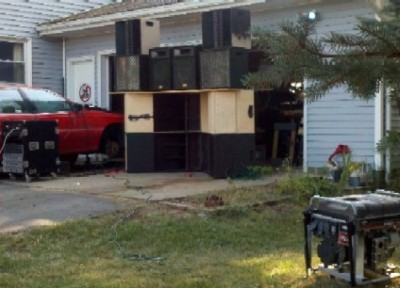

:hyper: As promised here are the pics.
Notes: The Otops were at 40V and the Titans were at 60V
Just to make it interesting we ran the system on my generator as we will be doing Aug28.
My 4 21" direct radiators could never provide the wide and long even bass that this rig provided.
The B52s were not is use.
Here is the stage stack. 2 Otop 15's melded, 2 Otop15's straight, 4 T48's powered by 2 Crown XTi4000's.

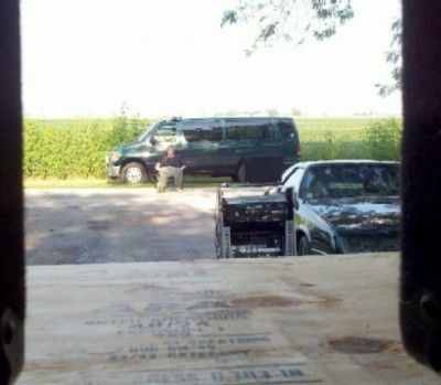

Here was the location of the first lobe we encountered as described by Ewetho
