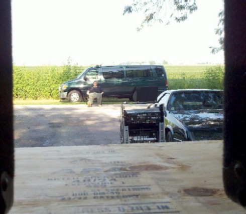

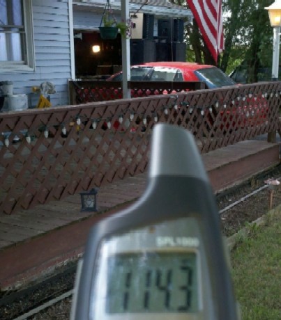

:hyper: As promised here are the pics.
Notes: The Otops were at 40V and the Titans were at 60V
Just to make it interesting we ran the system on my generator as we will be doing Aug28.
My 4 21" direct radiators could never provide the wide and long even bass that this rig provided.
The B52s were not is use.
"BaronVonSteve"

The tops were at 30% less power than the titans. Freq between mid and high not problematic at all. A lift in the mid and at 2K and beyond, flat. The stacked arrays made quite a difference.
