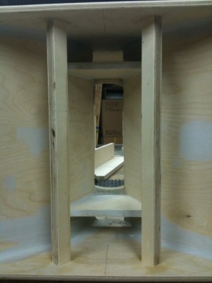

Took Harley's advice about the Piezo Brace Jig and modified it a little

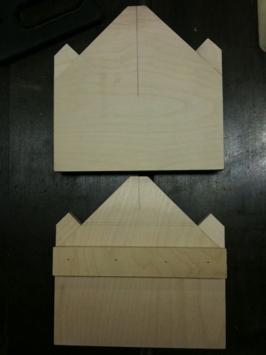

pic.1 These are my version of Harley's Piezo Brace Jigs with stops for both the depth and the spread

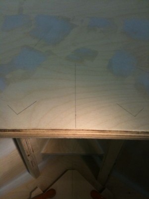

pic.2 After drawing a center line I transfer the location on top to see where the brads go

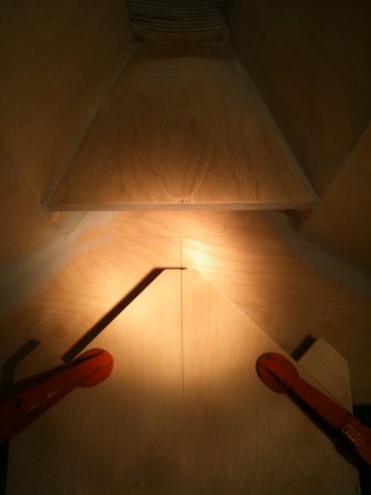

pic.3 The center of the cab has a line to line up with the center of the jig then clamp it

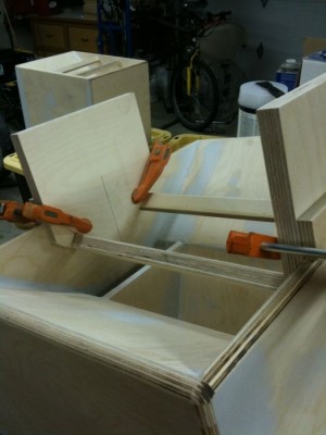

pic.4 Once the jigs are in place just pull the braces up tight and nail from the top with 1" brads
pic.5 I used the yellow wood glue for these as the pl would be way to messy for this, I was liberal with the glue then 4 brads or so into the top and remove jigs and wipe off excess with a damp towel, worked great and I am sure I will use these jigs for a long time!
