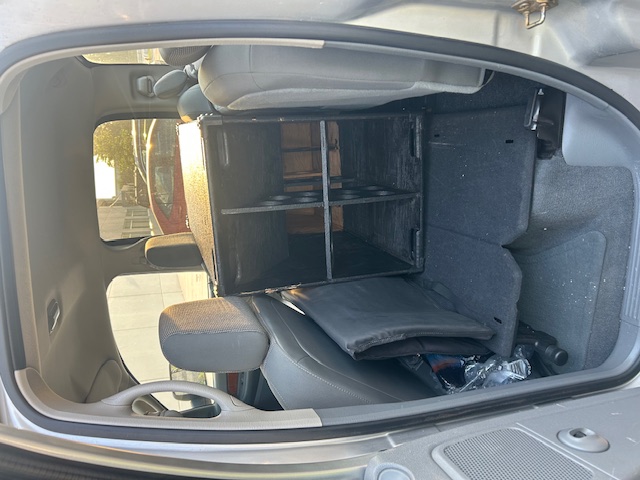

I have not been on here in a while :noob:, but I have been using my Tuba 45 sub horn in my truck almost daily 8). I found that this 18.5" wide horn fits nicely in the back seat of my 06 dodge with the rear seat folded up. There is about 62-65ish inches between the doors for about 20 inches between the horn mouth and the closed door. I have been running this set up for at least a year now and have been playing it as hard as I could while maintaining that it sounds good. I believe I can hear distortion of some kind at the last few notches on the volume knob. The max volume level reads 40 on the display and I get about a doubling of voltage about every two notches of adjustment. I find that for most music volume 36-38 is peak output with full clarity. At volume 38-40 I detect no loudness gain but a muddiness in the sound occurs. The amplifier is a Rockford Prime 750.1. I adjusted the gain structure to match the rest of the music to my liking, certainly not up past half gain as I recall. The drivers are paralleled for a base 2ohm load and the amp should be capable of 500w at 2ohms according to spec sheet.
I have said this before but there is something special about these horn-loaded subwoofer enclosures when compared to a direct radiator configuration. I noticed this way back when I built and started testing my first tuba45. At the time, I had a basic Behringer single 18" passive pa subwoofer in my possession for comparison as well as a 12" home theater sub in my house. I remember being able to test each and use an SPL meter to set the level equal and I would get very different effects beyond the sound/timbre. With the horn the sound energy seemed focused at my ears and did not interact with the environment that much, where either of the direct radiator designs that I was testing would often make things in my house rattle audibly before I felt like I was hearing the same level of sound as with the horn. I notice something similar with a horn set up in my pickup truck. I had to put a lot of work into sound deadening the cabin of my old truck to fix the tin can echo and rattles. I had multiple layers of deadening mat in the roof and doors and back panel wall to make it sound good. I have done nothing to doctor the cabin of my current truck, and I hardly get any rattling even at war level. The mirrors shake like crazy, but I don't hear rattles like I would expect. This has always fascinated me and been a major factor why I endorse these horn-loaded designs. If were to go the conventional car stereo route to achieve what I have, I would have to spent upwards of $4000-6000 for electrical upgrades, acoustical treatment, amps and subs to be as loud as my truck currently is. As it is now, I can play the system with the engine off for a long time and never hardly drag on the batteries. I only have a few hundred invested for the entire system.
I had never put a meter on the system to measure voltage output of the amp until now, I just sent it as hard as it sounded good and wondered just what these little 8" drivers could handle. For the average car audio bass head enthusiast, I am not ashamed at the output. It digs just about as low as I care to go and for the cost it just can't.
In conclusion; I measure amp voltage output at max volume(40), to be at 22.3vac. When I back the knob down to around 36-38 I get 12-15vac. If I remember correct, the recommended voltage peak on one of these MCM 8" drivers is 22-25vac. I initially wanted to compare a dual 8" setup to a lab12 which can take 50vac and series configuring two MCM 8"s gets the same power handling and roughly same cone displacement for 1/8th the cost. I was hoping that I was going to get to report that I was pushing closer to 35-40vac into the drivers but alas I am feeding them exactly what they should be able to handle. What is that then, 23v into a starting 2ohm load 250watts total peak power? Oh the money I could have saved if I had gotten into these horn-loaded designs years ago!
