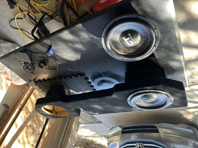

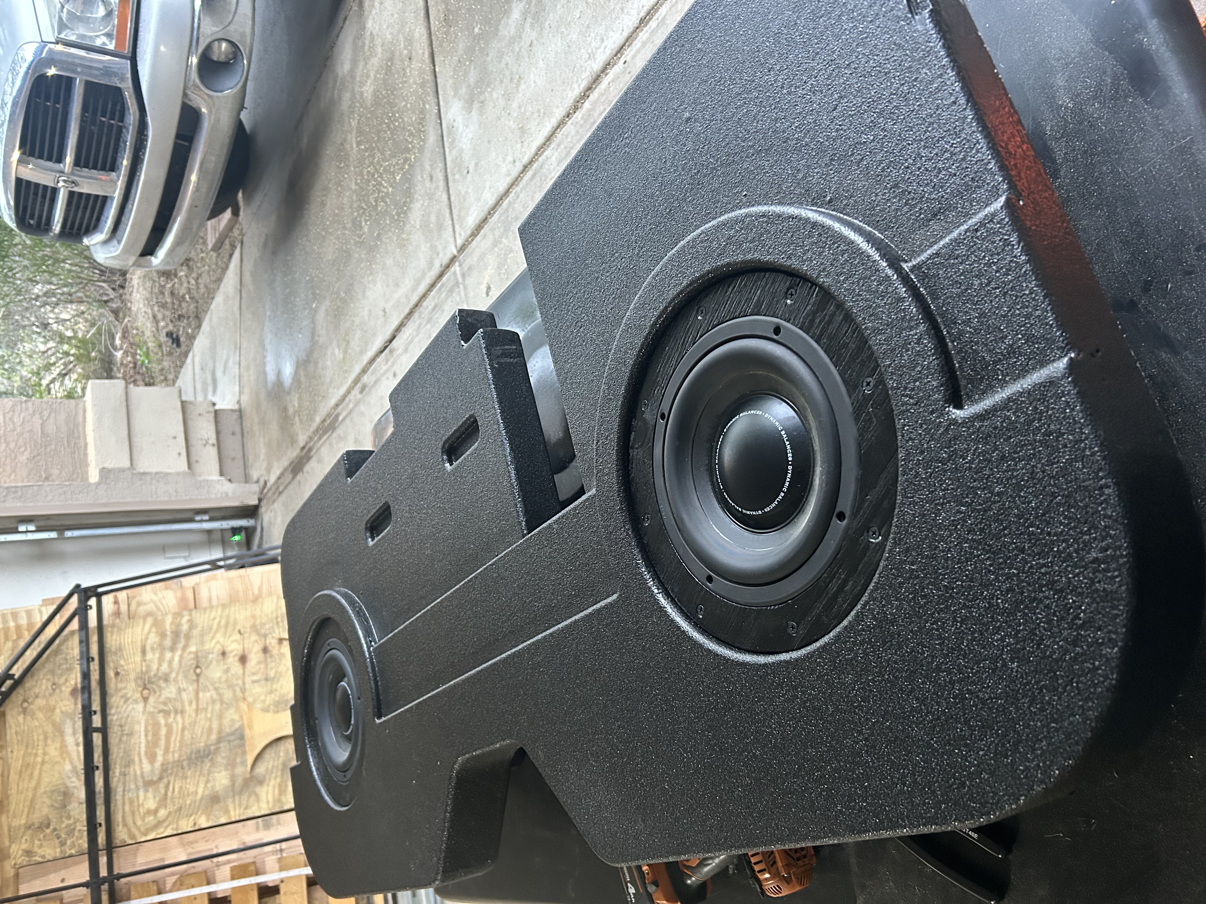

I have not been on here in a while :noob:, but I have been using my Tuba 45 sub horn in my truck almost daily 8). I found that this 18.5" wide horn fits nicely in the back seat of my 06 dodge with the rear seat folded up. There is about 62-65ish inches between the doors for about 20 inches between the horn mouth and the closed door. I have been running this set up for at least a year now and have been playing it as hard as I could while maintaining that it sounds good. I believe I can hear distortion of some kind at the last few notches on the volume knob. The max volume level reads 40 on the display and I get about a doubling of voltage about every two notches of adjustment. I find that for most music volume 36-38 is peak output with full clarity. At volume 38-40 I detect no loudness gain but a muddiness in the sound occurs. The amplifier is a Rockford Prime 750.1. I adjusted the gain structure to match the rest of the music to my liking, certainly not up past half gain as I recall. The drivers are paralleled for a base 2ohm load and the amp should be capable of 500w at 2ohms according to spec sheet.

18.5" wide Tuba 45 loaded with 2 MCM 55-2421 8" drivers, in the back seat of my truck!

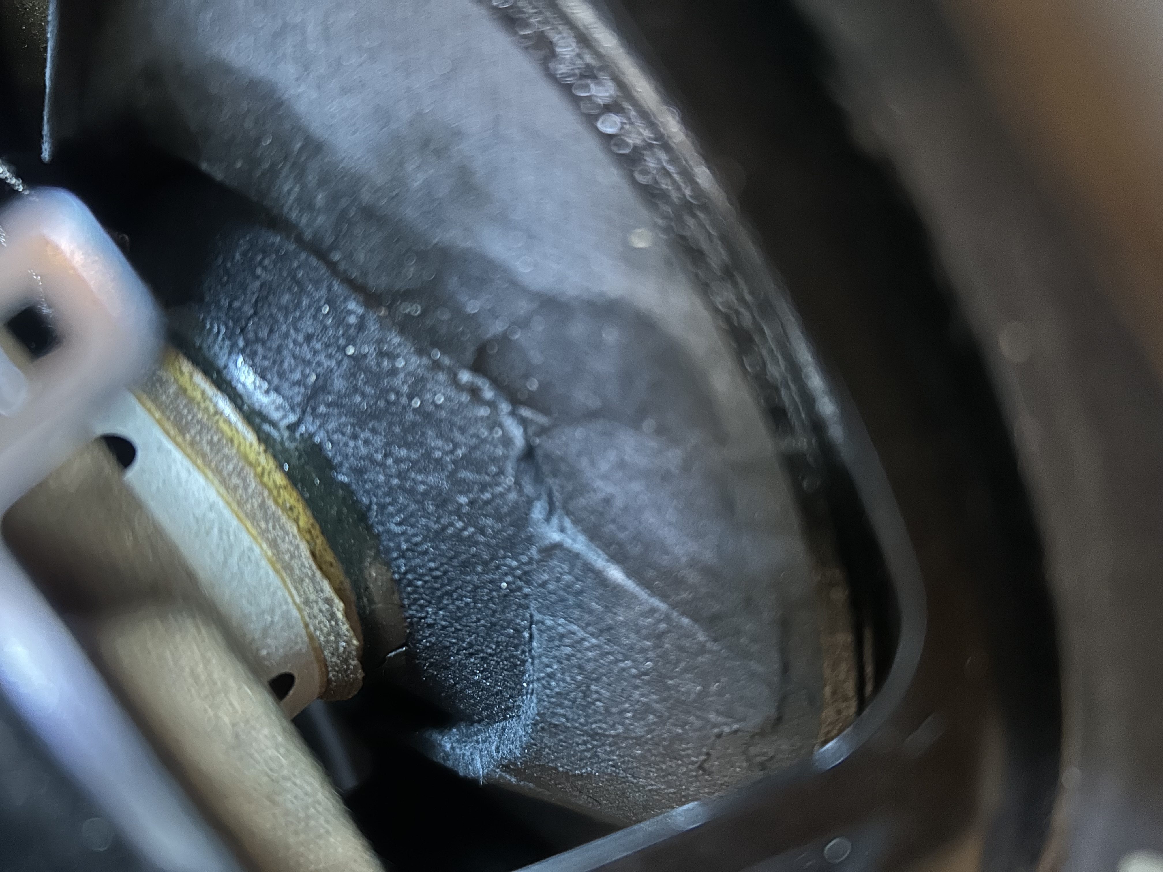

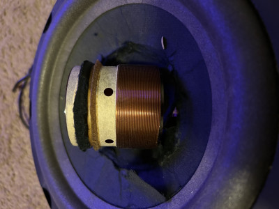

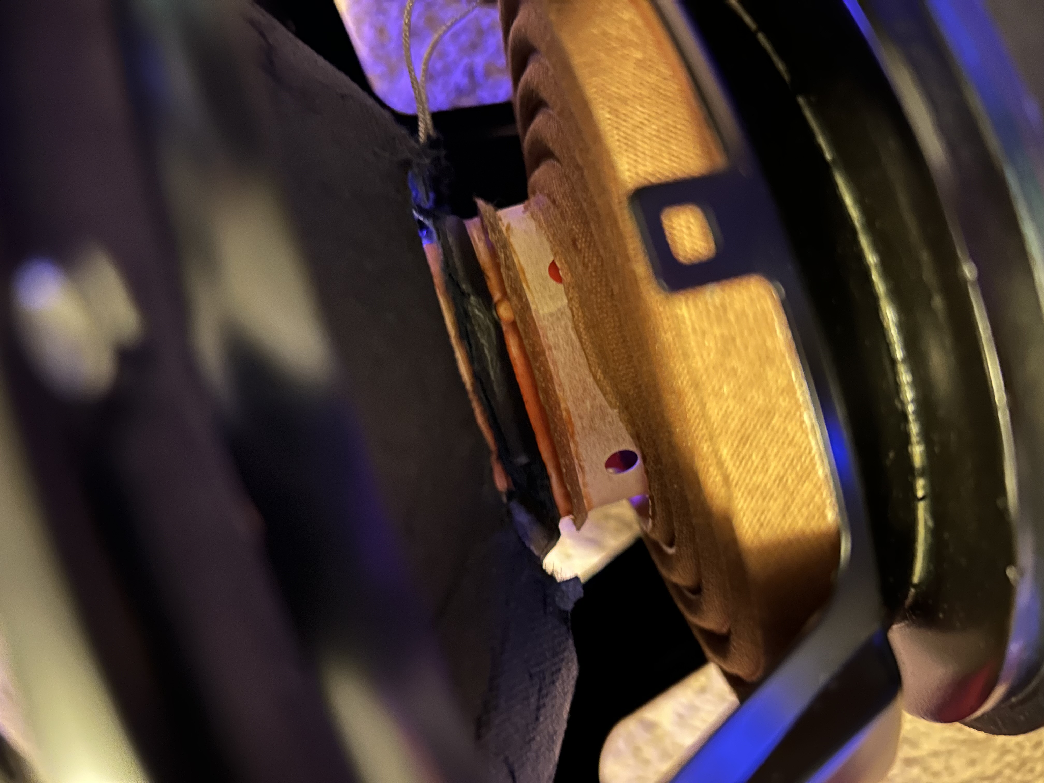

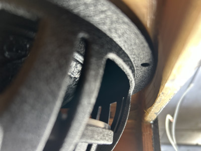

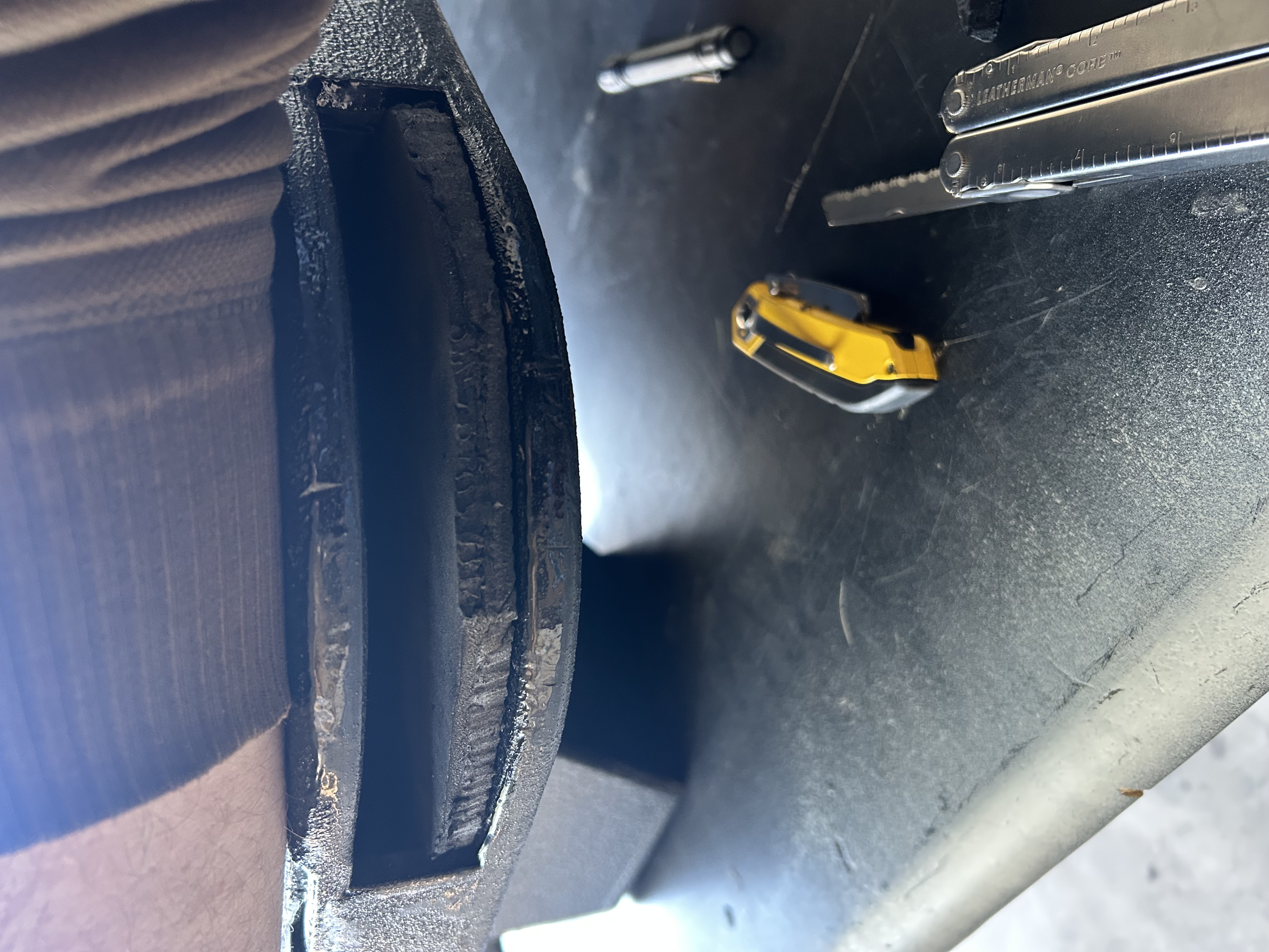

I finally hatched one of the MCM 55-2421 8” drivers yesterday. I was able to replicate the event and took a voltage reading and set to peak hold the meter climbed to 22.66vac. Looking at the coil it was thermally within the limits, but mechanically it Marty McFly style yeeted the coil out of the hole and through the cone. The spider ripped at the former as well as the cone. The dust cap I found part way down the horn throat. I have not inspected the other driver yet as it has not failed but I imagine it is pretty fatigued. I would like to find some stronger drivers to use in this enclosure and see what it can do.

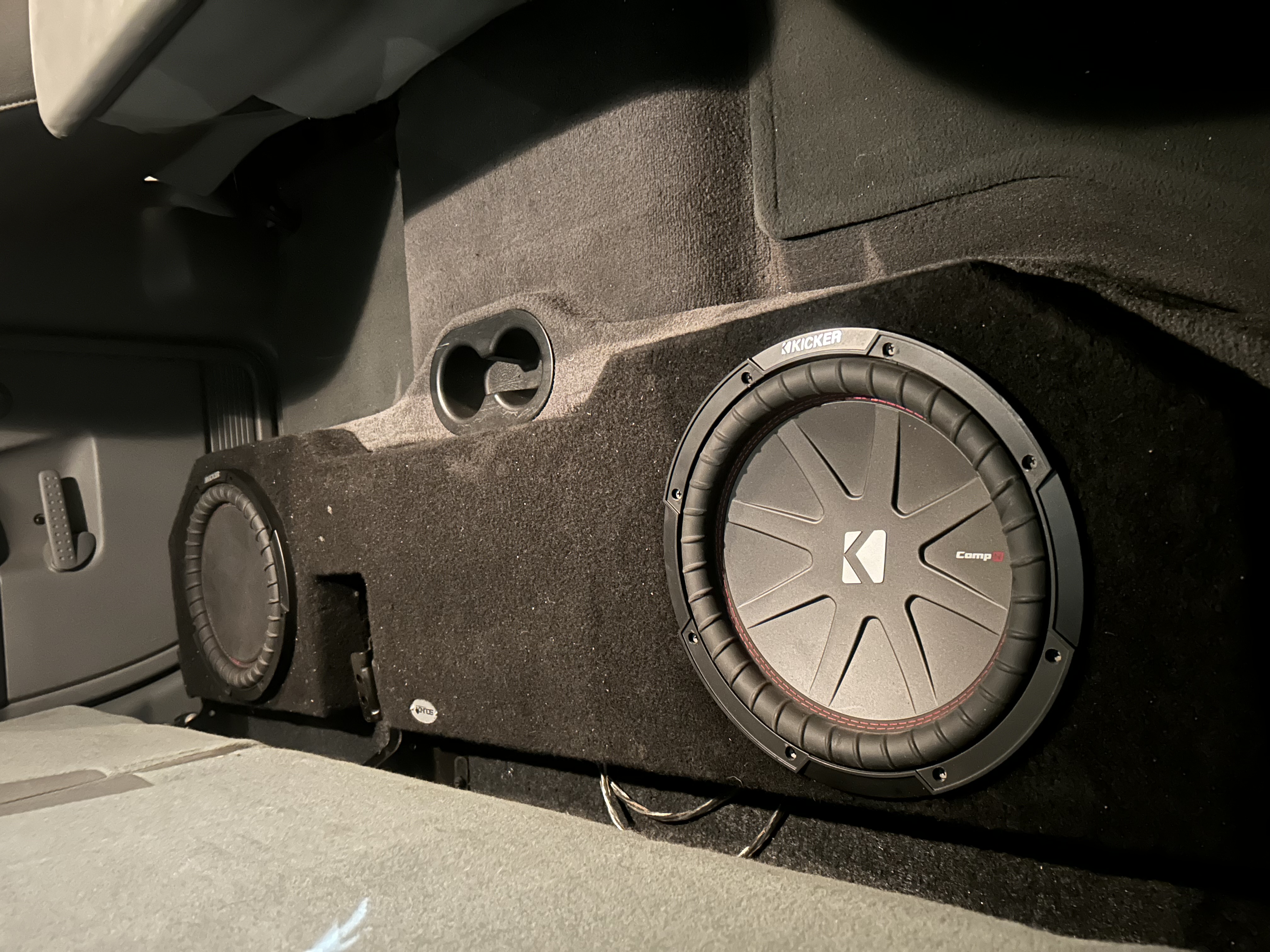

I have tried many things in my Ram pickup truck in order to achieve good bass response. I have manipulated prefabricated enclosures with different driver configurations and I have achieved some good results. I took one enclosure that was supposed to be about 0.9 ft.³ internal volume per side that was ported to a predicted 48hz frequency designed for 10inch drivers, this as you can imagine was peaky above 50 Hz and had no low frequency extension. I made adapter rings and installed 8inch drivers and then installed some foam in the ports to lower the port tuning frequency to an estimated 36Hz. the result was a much smoother flatter response with some low frequency extension. I would report it sounds great that way. I also acquired and tested a sealed enclosure that is supposed to have a total net volume of 1.2 ft.³ this enclosure is designed for 12 inch drivers which sounds terrible and is peakier above 50 Hz and worse than the other enclosure with even less low end extension, I optioned to install a passive radiator in this enclosure, which I predict had a tuning frequency of about 26 Hz. This configuration has good low end extension and seems to sound very good to me. Although I have improved the response of these set ups they just fall short of greatness.
I would like to express with solemn conviction that nothing I have ever done has been able to compare to the sound signature of these horn loaded enclosures. Nothing sounds as good, or has as much control of air molecules. Nothing is as smooth, plays as low, or is as tight as these horn loaded enclosures are. yes they are big. Yes, they are annoying to build, but if efficiency and sound quality is your focus there is likely never going to be an equal.
I have recently gotten back into the car audio scene and even competed in a formal car audio competition recently I have had the ability to share and demo my truck with this horn loaded enclosure in it, now for pure SPL output it is lacking compared to other configurations with similar enclosure form factors, but everyone agrees for sound qualities sake, the set up I have is truly impressive. I just want to share this information for anyone who is skeptical I assure you there is something special about the sound signature that these horns produce without a doubt.

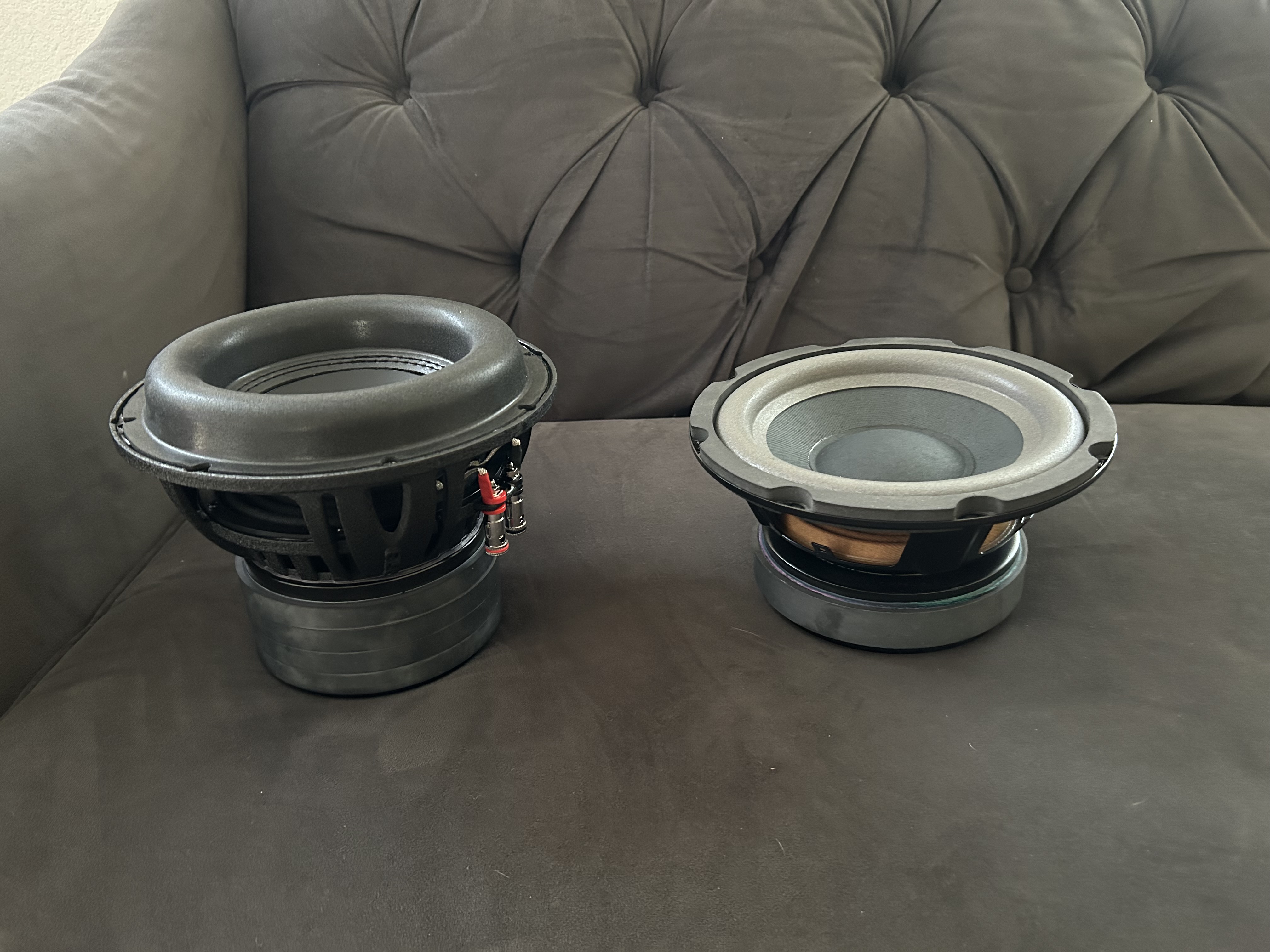

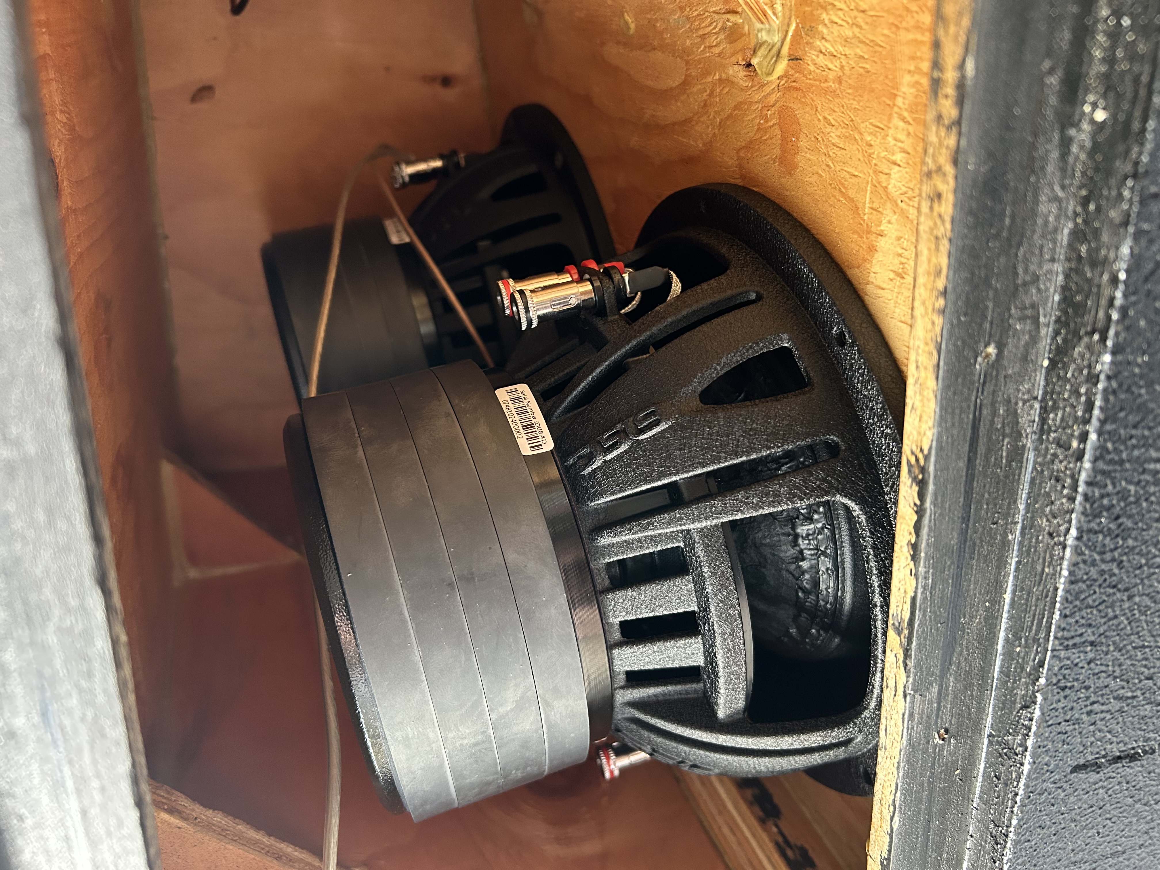

I picked up a set of very beefy 8” drivers that I am going to test out in this enclosure. They already do not fit through the side cover holes. The am going to have to trim some of the side cover plating to get these guys to fit!
ACUA
Posts: 559
Location: Tucson Arizona
Re: MCM 55-2421 8” driver VS everything
#100 Post by ACUA »

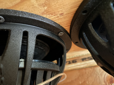

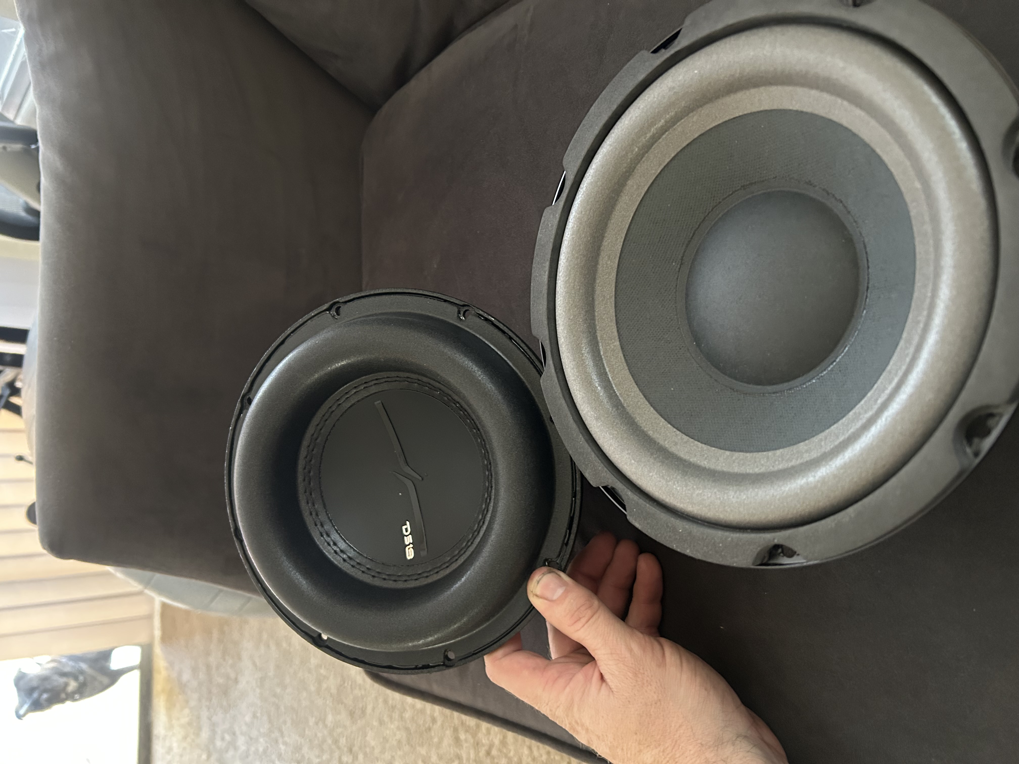

I had to carefully smash/fold the bubble surround of these drivers to squeeze them through the cover window but they fit with no modification and lucky me they fit snuggly, literally touching each other but the original screw holes lined up. Initial test suggests that the MCM 8”s seem to have a smoother softer timbre/tonality. These drivers are stiff and there is a slight oddity to the sound signature to my ear. I am not sure how loud these drivers will go but I know that they have much more in them than the MCM8”.
If you wanna know these are DS18 ZXI8.4D 8”
