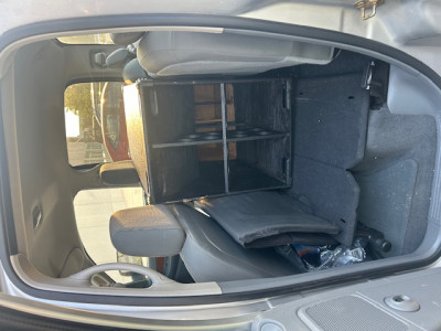

, but I have been using my Tuba 45 sub horn in my truck almost daily
. I found that this 18.5" wide horn fits nicely in the back seat of my 06 dodge with the rear seat folded up. There is about 62-65ish inches between the doors for about 20 inches between the horn mouth and the closed door. I have been running this set up for at least a year now and have been playing it as hard as I could while maintaining that it sounds good. I believe I can hear distortion of some kind at the last few notches on the volume knob. The max volume level reads 40 on the display and I get about a doubling of voltage about every two notches of adjustment. I find that for most music volume 36-38 is peak output with full clarity. At volume 38-40 I detect no loudness gain but a muddiness in the sound occurs. The amplifier is a Rockford Prime 750.1. I adjusted the gain structure to match the rest of the music to my liking, certainly not up past half gain as I recall. The drivers are paralleled for a base 2ohm load and the amp should be capable of 500w at 2ohms according to spec sheet.

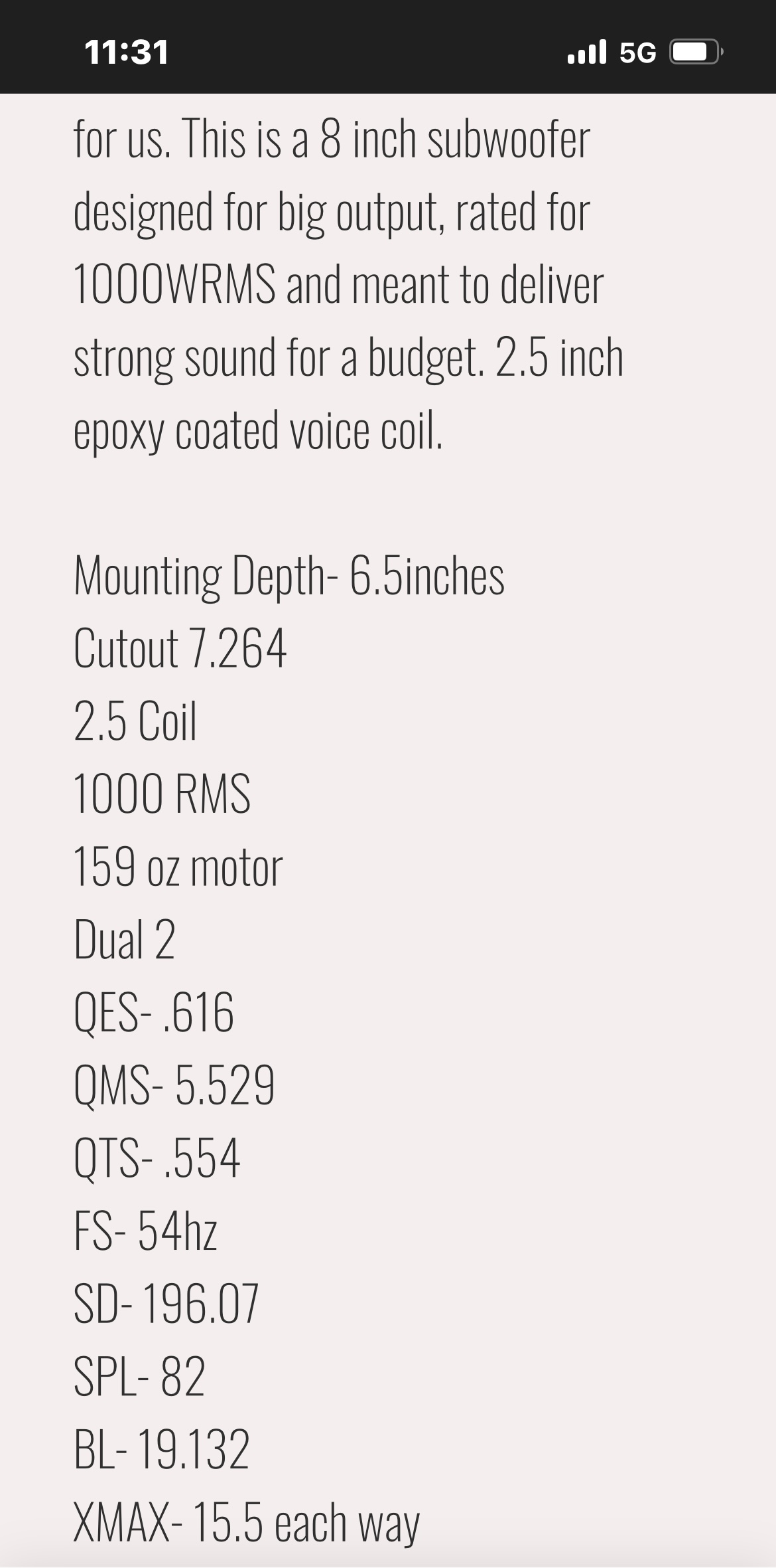

With regard to my tuba 45 18.5” wide dual MCM55-2421 8” loaded horn, I would like to consider upgrading the drivers for the most ridiculous option on the market.
I realize the relationship between wide and narrow cabinets for a given driver size has to do with particle velocity and the efficiency relationship between laminar flow and turbulent flow, or something like that!!! To small a path and there is a restriction, to big and the coupling goes away. My 18.5” wide cab is on the small side meaning to me that two 8” drivers moving at 8mm of excursion/displacement may be about all the horn can handle, and increasing the power and excursion with beefier drivers may not yield much more output. I still want to pose the question.
How much more spl could I get with two of these little monsters?
https://www.audioaceinc.com/product-page/str8-nst
These are SPL subwoofer drivers, the entire focus is to withstand a lot of electrical power and mechanically handle a lot of movement. Fidelity and sonic accuracy is hardly considered!
Also another question, with an Fs of 54hz might I get away with running this configuration with the door removed from the sealed chamber? This is a slightly expensive experiment to preform at nearly $500 for a pair. I really want to know how much peak spl I could squeeze out of this horn when placed in my truck! I am tempted to buy a set of drivers like this to test! My curiosity is spiked!!

Output is more or less linear with respect to Xmax. But those 'monsters' have high Qes as well as Fs and the surrounds are silly. If you want maximum output use a twelve. The PRV 12W1600 will beat two eights. As to no door that's a no-no.
