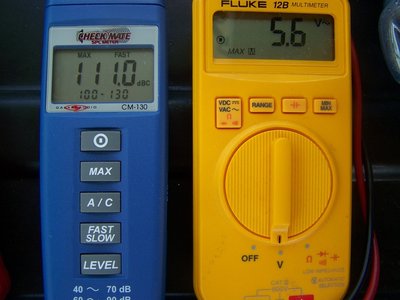

doncolga
Posts: 1967
Location: Statesboro, GA
Re: Lab12 T30's
#97 Post by doncolga »
Here's a couple other pics.
Donny Collins
Two 18" Tuba 30's 3012 LF
Two 26" Tuba 30's Lab 12
Presonus Studio One DAW

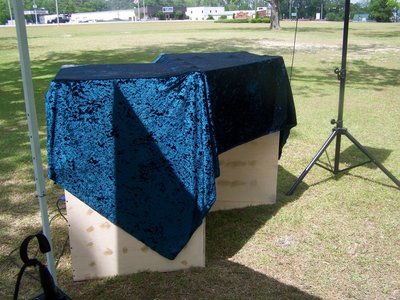

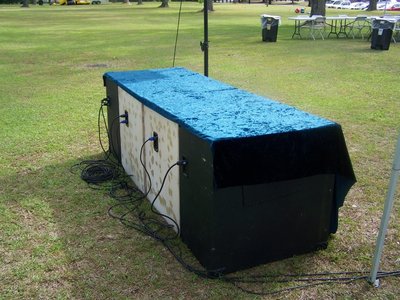

doncolga
Posts: 1967
Re: Lab12 T30's
#98 Post by doncolga »
Here's a V plate...good grief... :clap:
Donny Collins

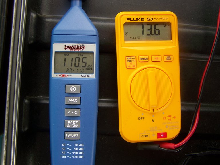

doncolga
Posts: 1967
Re: Lab12 T30's
#99 Post by doncolga »
Sheesh...I wish I'd V-plated earlier for this event. When I had just two T30's, I couldn't tell a huge difference between running them side by side vs. V-plating. Four running side by side vs. four V-plating seemed to be a much bigger difference. I was *really* surprised. I had to cut the sub amp back quite a bit. It was definitely more sensitive, but the coverage also seemed to improve. I don't think I got over 15 volts after v-plating, and those were on bass heavy songs. I'm just super happy about it.
Anyway, overall impressions were great. Most of the comments I got were like "Man...that is so clear". The throw was great and dispersion really, really wide. One Panda dubstep tune was just amazing. It was obvious folks really enjoyed hearing them.
Sanding, painting and finish hardware coming soon.

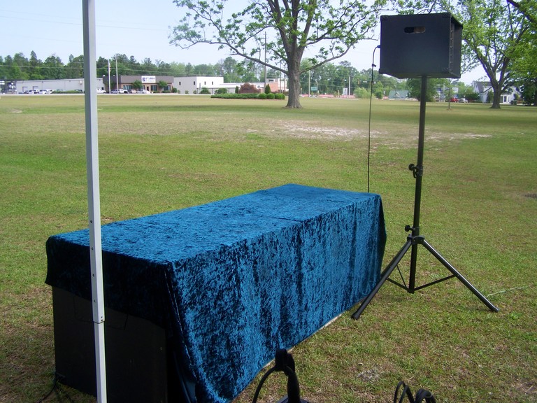

shawn_g
Posts: 386
Location: Logan, OH
Re: Lab12 T30's
#104 Post by shawn_g »
:clap: Very nice. Is the tablecloth moving from the wind or the subs?
doncolga
Posts: 1967
Re: Lab12 T30's
#105 Post by doncolga »
I think most of that movement came from the wind, but the subs were doing some moving too. Again, the V-plate was impressive...noticeable improvement from the arrangement in the video. I don't think I'll ever not V-plate again...it's certainly worth the extra effort. Even outdoors, it seemed much more efficient, so less stress on the amps and drivers...and it's a smaller V-plate footprint too. Come to think of it, that's another reason I chose the T30's instead of 39's or 48's. As I considered my regular venues, I didn't have that much corner or wall space for boundary loading.
Speaking of that...v-plating is not exactly inconspicuous, so I'm wondering how to make them as visually appealing as possible at venues where aesthetics is a priority, like a wedding reception. Seems like a white sheet draped down the front would be good to put some uplighting in. Any other ideas?
