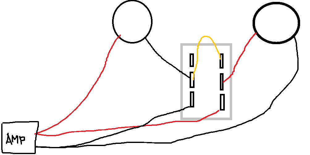

Seth, After your prior comment on wiring I was thinking a four pole speakon socket that connects the 12s in series and has a pass through to a second speakon socket . (for a potential future of being used with a mains power supplied amp, coupled with a 2nd Titan cab)
AS WELL as ; a conventional 2 pole terminal plate that connects to the 12s in parallel for the standard speaker cable coming fromthe 12v amp.
sound right ?
Re: Titan 48 for 12v build// No Labs in the UK
Posted: Mon Jun 19, 2023 12:40 am
by Seth
Mishkin wrote: Sun Jun 18, 2023 1:11 pm Seth, After your prior comment on wiring I was thinking a four pole speakon socket that connects the 12s in series and has a pass through to a second speakon socket . (for a potential future of being used with a mains power supplied amp, coupled with a 2nd Titan cab)
sound right ?
Unfortunately, the wire combinations will create shorts having two jacks wired that way.
There are a few ways to do it though. If it were mine, I think I'd opt for a DPDT switch. Sorry about the horrible diagram quality.
However, the safest way to do it, so there are no mistakes (oops the switch was in the wrong position and the smell of hot electronics fills the air) is to have it be an actual wiring change behind the jack plate.
Here's how to wire the DPDT switch option.

I've beeen wondering if theres anyway to do this dpdt switch option, or something like it, but in co-ordination with two sockets? So as to make it a little less likely fry things because the switch got knocked the wrong way (you'd have to flip the switch wrong and plug into the wrong socket to run it at the wrong impedance).
Could that work somehow?
Posted: Tue Jun 27, 2023 10:12 pm
by Seth
Mishkin wrote: Tue Jun 27, 2023 5:05 pm Thanks again seth,
No problem Kairos :thumbsup:
I think you could achieve that with a 4PDT switch. But, my brain's a little spent on other projects to create a wiring scheme at the moment. I'll get back to you on that.
There's another really simple and safe option though... Use a single 4 pole SpeakOn jack in the cab and make two separate speaker cables, one for 8Ω one for 2Ω, and just do the parallel or series wiring within the SpeakOn connector itself. Keep one cable always attached to your 12v system and the other cable with your mains powered amplifier. That way, wherever you plug the cab in, it'll automatically be wired correctly.
Posted: Wed Jun 28, 2023 12:31 am
by Seth

Seth wrote: Tue Jun 27, 2023 10:12 pm
How's the project progressing, BTW?
thats a much more elegant solution :)
But If i've understood right - that would mean no potential to pass through to the next titan cab? as youve used terminals 3 and 4 on the speakon socket with the alternate wiring option, Is that right ?
Sadly the project has been stalled a bit, the drivers and dsp were coming from france and since brexit and the UK leaving the european union that now requires taxes and customs paid, the processing isn't efficient yet as this is all relatively new so the parts have been held ransom by this international bureaucracy fail :(
will update as soon as i can get building, im very itchy to make this happen .
Hope your evening is going well.
Posted: Wed Jul 05, 2023 8:02 pm
by Seth
Mishkin wrote: Wed Jul 05, 2023 3:47 pm But If i've understood right - that would mean no potential to pass through to the next titan cab? as youve used terminals 3 and 4 on the speakon socket with the alternate wiring option, Is that right ?
That is correct that pass through within the cab would not be possible. However, you could very easily wire in a female SpeakOn pigtail at the speaker end of the the speaker cable to pass the signal on to another cab.
