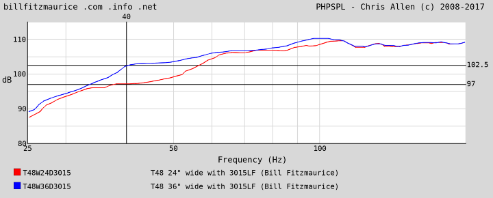

Here's the comparison you asked for...
That 5.5dB difference is considerable, in my opinion. Properly EQ'd the 36" cab on only 127 watts/32 volts will produce the same output as the 24" cab on 450w/60v.
That said, you will definitely want to get the DSP we talked about before. You can play sub 30Hz content, but you must have a high pass filter engaged at 40Hz when using less than 4 cabs. The sub 30Hz content will still be audible, but will be attenuated. When the time comes we'll also need to discuss methods of limiting voltage to the cab if you choose to upgrade to a more powerful amplifier.
You would need an amplifier capable of continuous (not peak) 900-1000watts at 4 Ohms to get the most out of a 3015LF.
